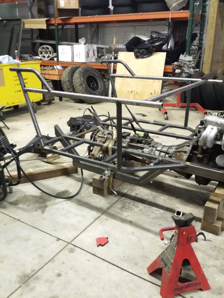

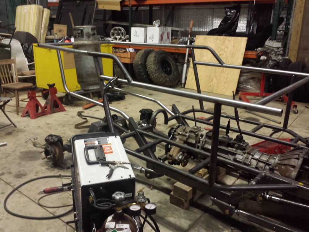

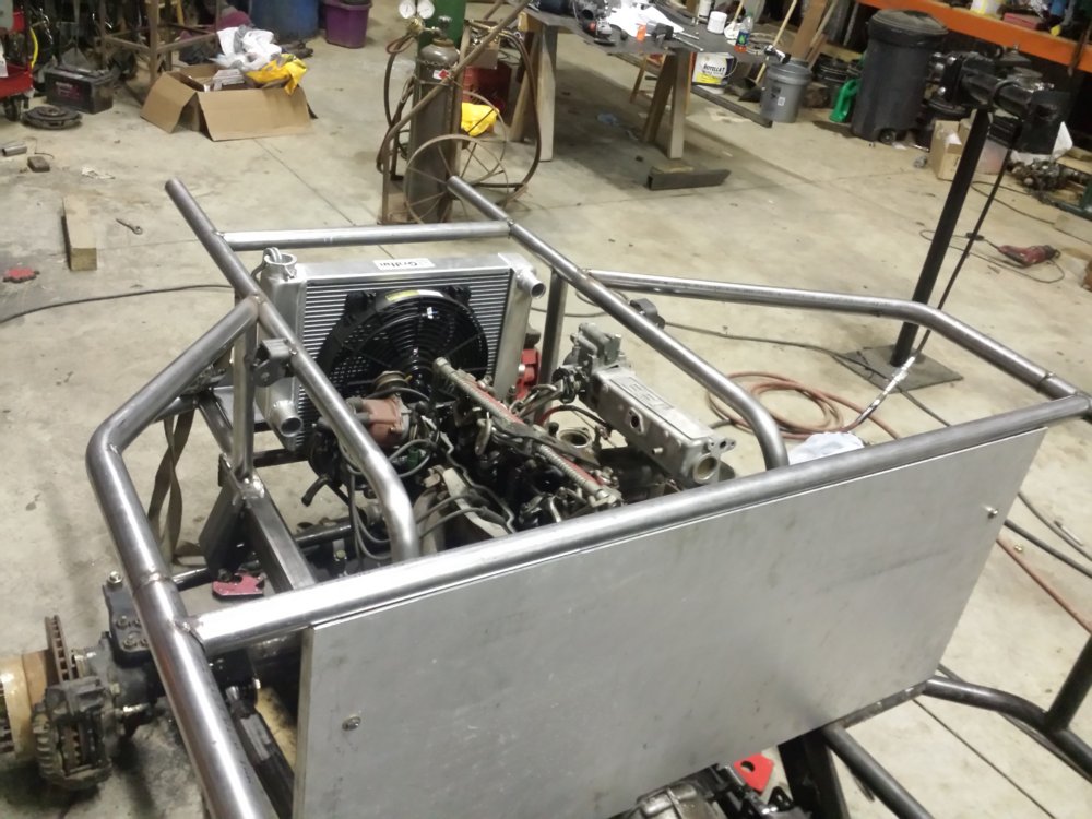

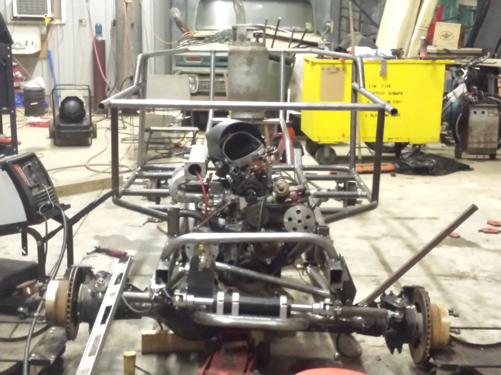

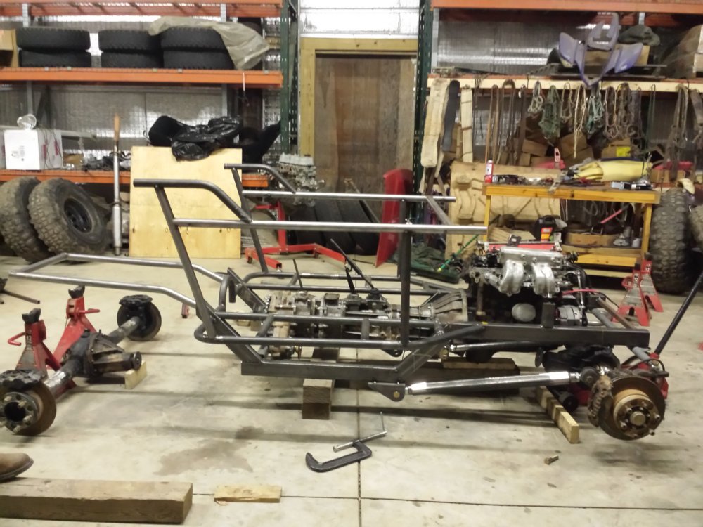

I figured I would go ahead and start a build thread for my buggy. So far I just have the motor trans and tcases mounted in the chassis. I'm using a lot of the parts that came out of my truck
Specs
22re on propane
W56
Stock duals
Mini truck axles
Not sure on tires yet but in the 37-40" range

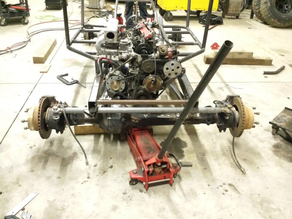

These are all the pictures I have right now but I'll take some more this week. Should be starting on the suspension Tuesday and and the roof and tail section
I'd love to have a lightweight buggy but I enjoy driving my rig around town way too much.
Planning on having functional brake lights and turn signals for some around town cruising if I want. I'm using the toyota pedal Assemblies

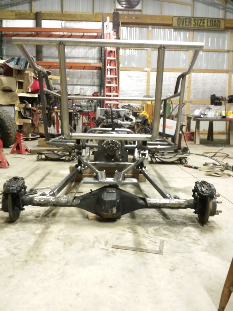

Why did you do the main rails with box tubing?
I'll post some more pictures next time I go to my shop
I like the look of it and its way easier to work with

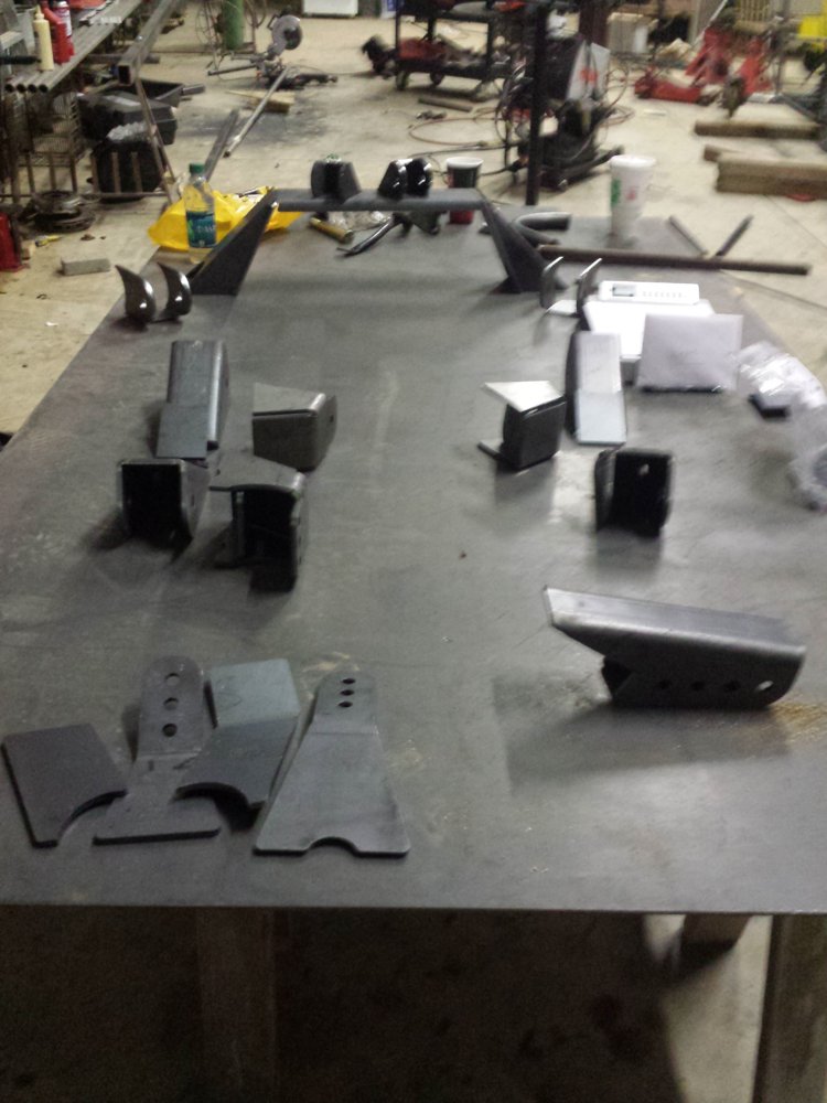

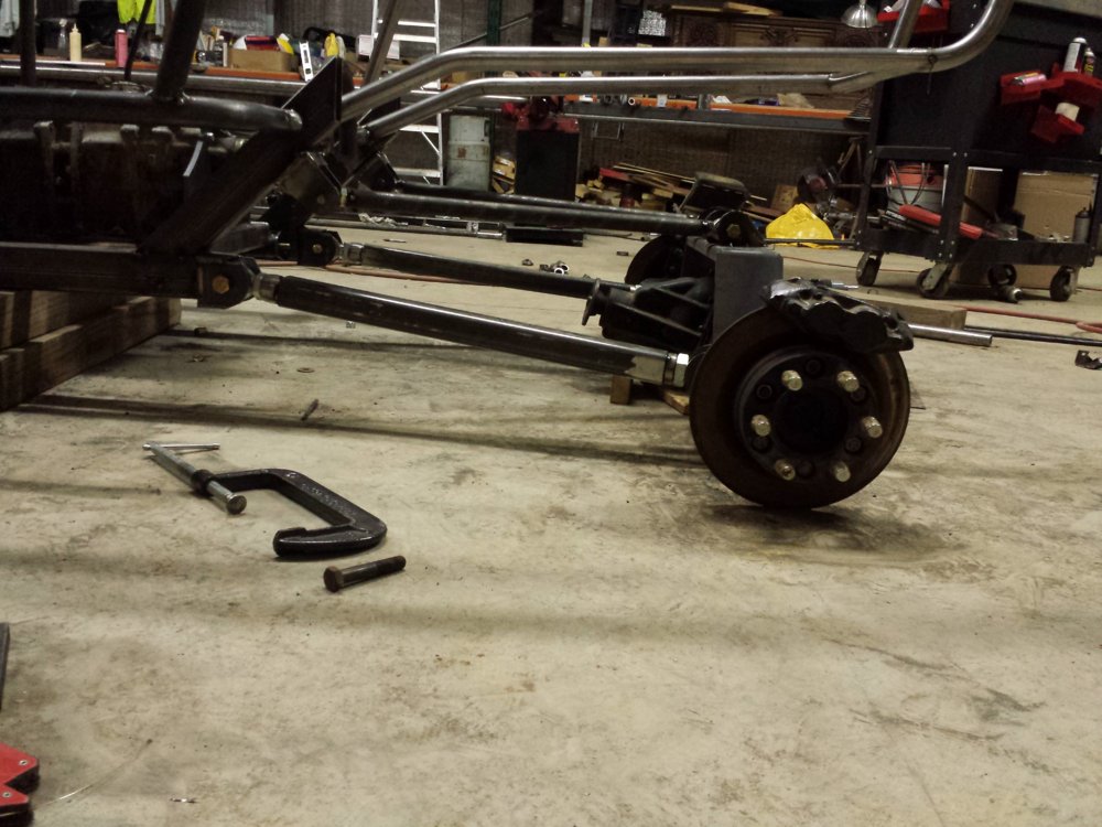

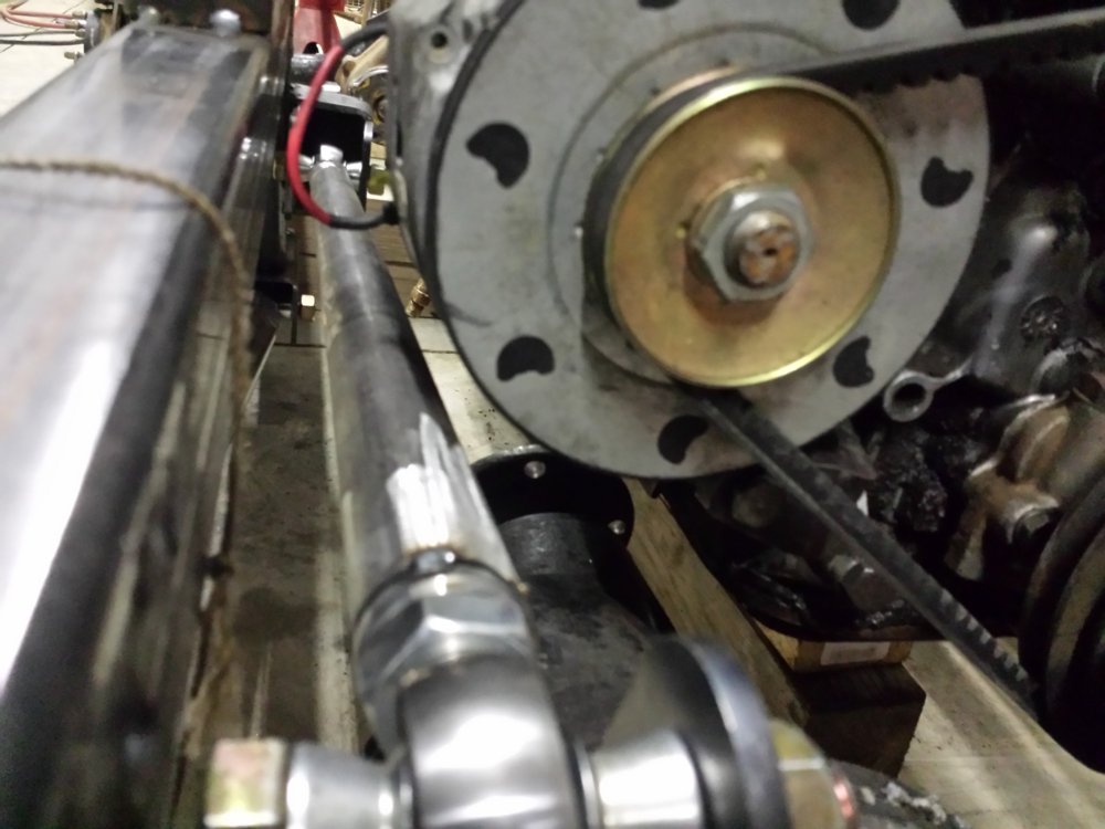

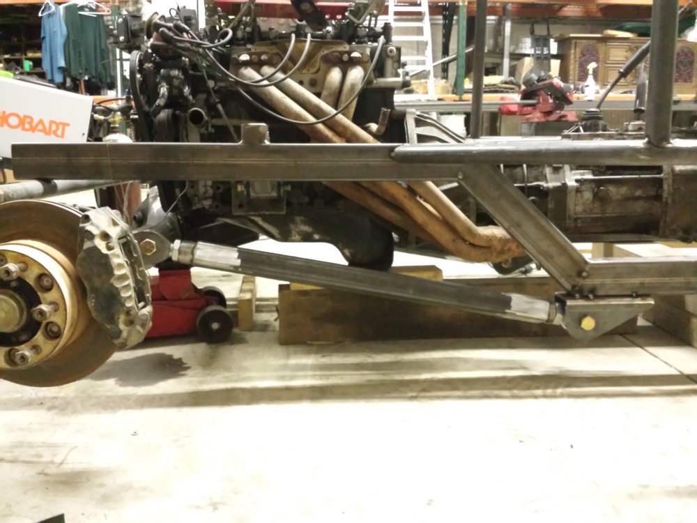

Link parts showed up from Barnes great quality as always now I just need to make it all fit somewhere

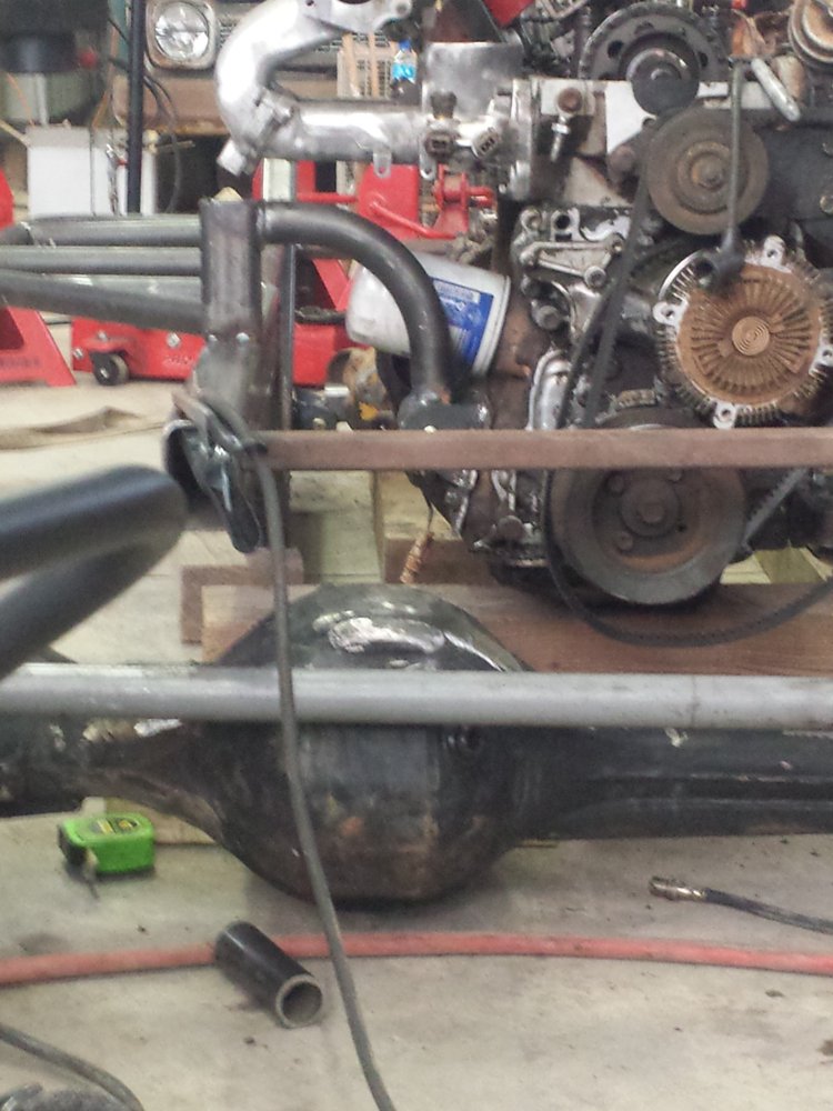

I'm gonna be lowering the frame side up link mount to decrease the seperation tommorow

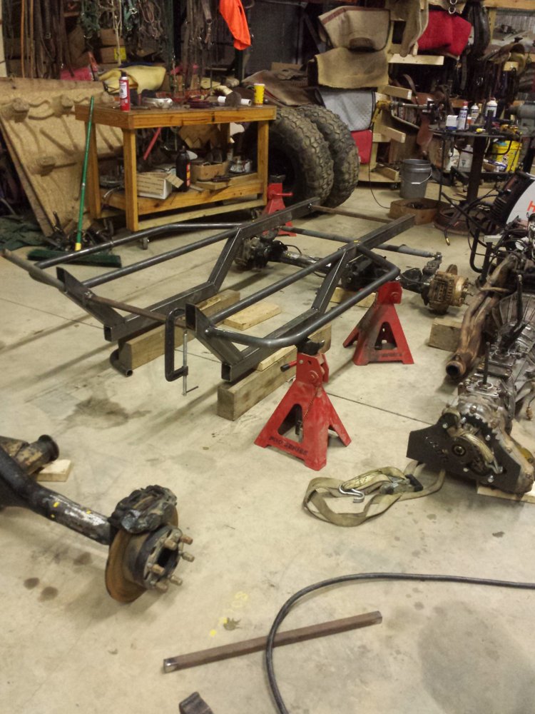

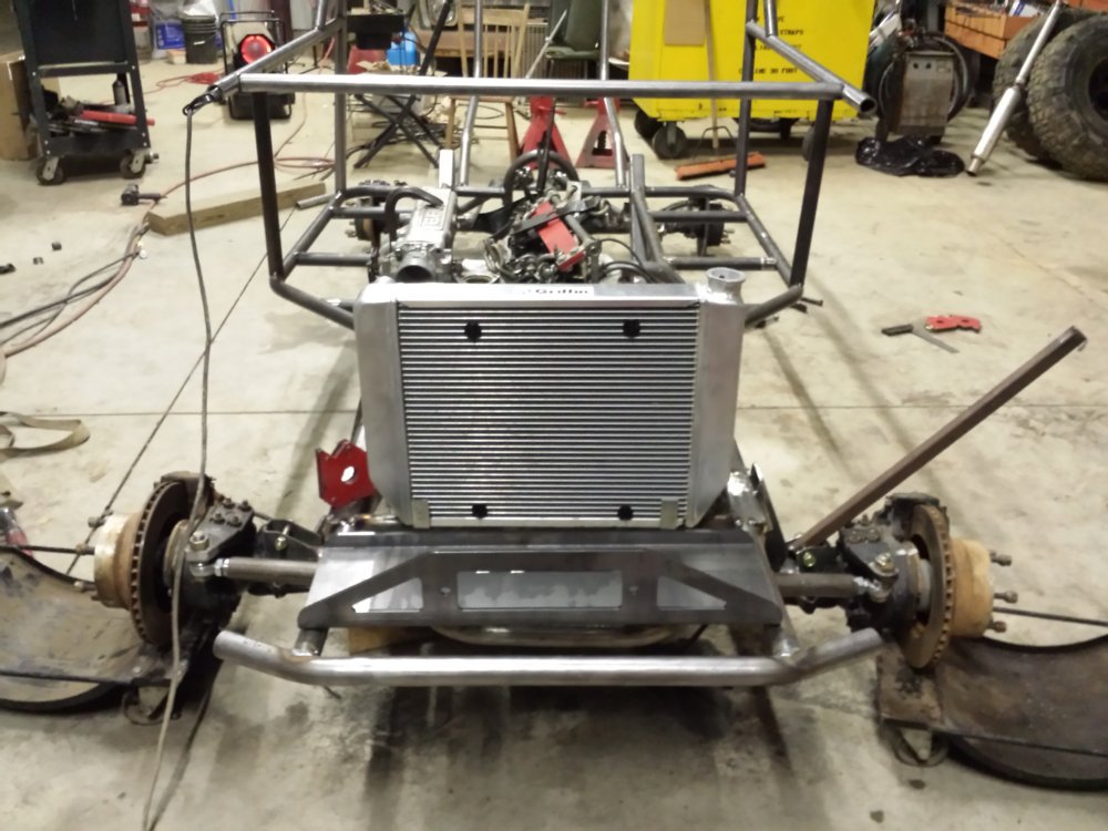

I decided to redo the front but I don't have a picture of v1.0 this is v2.0 but I'm really happy with how it turned out. Also have the seats mounts working on the firewall/ dash
