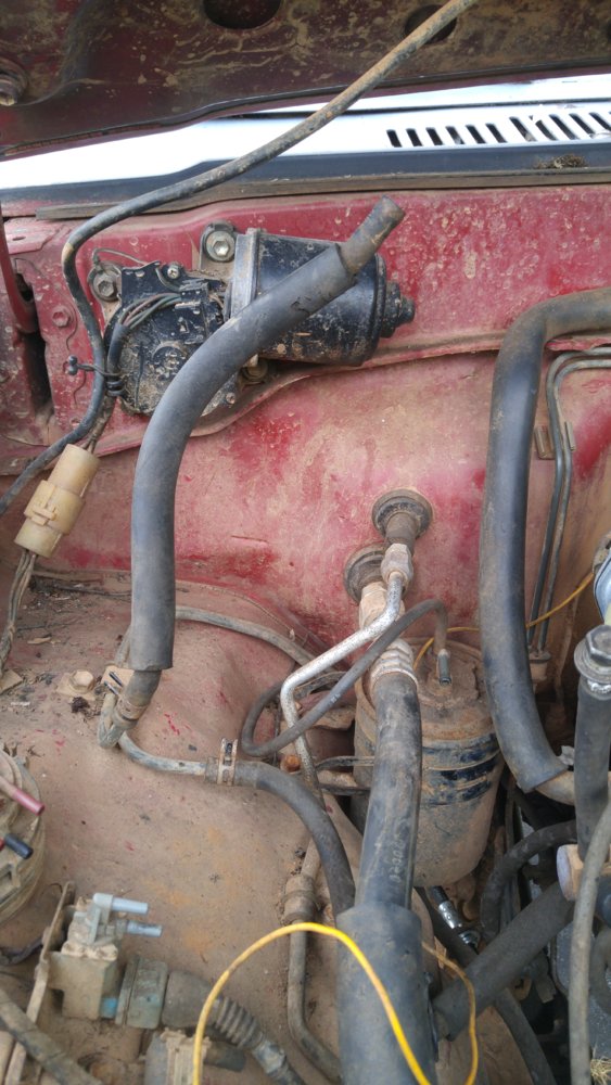

So I filled up with gas today and started having the problem again. So I figured I might have the vent and return line mixed up. When I blew into the hose I had hooked to what I thought was the vent it blew gas out of the tank.
I switched the lines and I can't blow through the other one that I originally thought was the return.
The one that's on the left and unhooked is the one I originally had as the return. Its is the one i can't blow through.
Can anyone confirm the one unhooked is the vent line?
