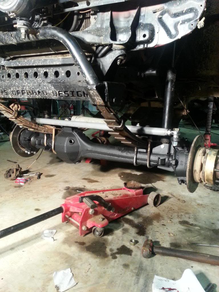

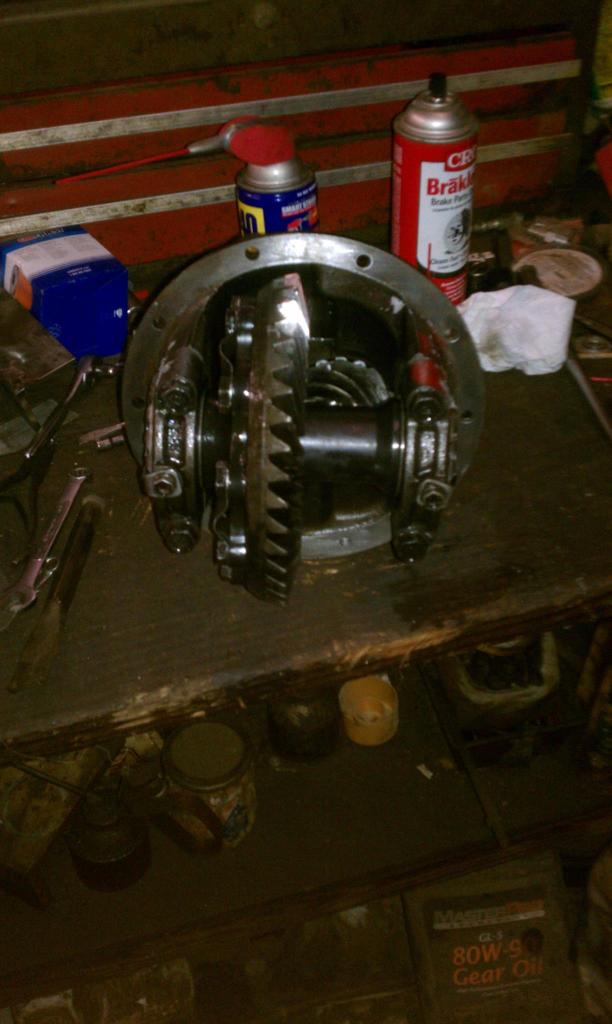

well i figured ide update some i put spools from ecgs in the front and back after breaking both lockers after that i decided i needed full hydro

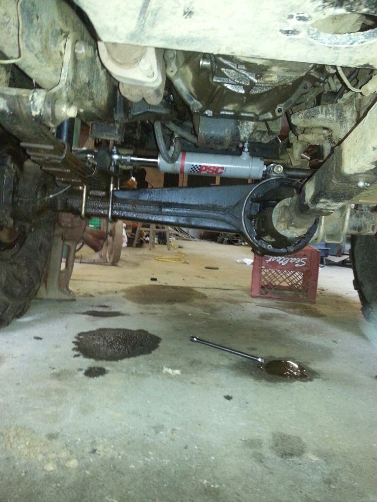

had the new steering in all new tc pump orbital lines res cooler ram wheeled it pretty hard around the farm and everything checked good.... then i went to uhwarrie with a buddy 4-20 had a blast till i started to go back down daniel to run the lower part again after doing it succesfully the first time it went down hill from there
i was sitting on the bypass side of look out hill for about two hours bc of this

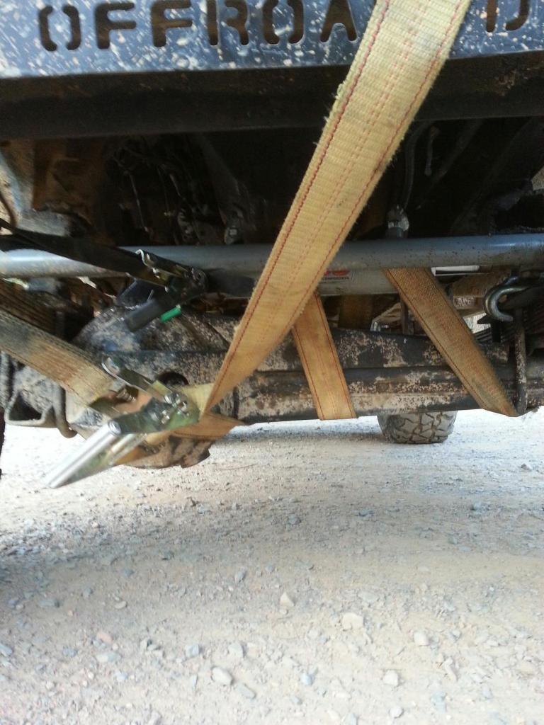

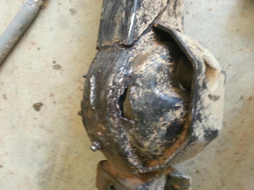

after some help from stuntman autoworks dirkadirka875 untchabl we got it back to the trailer. the problem was the axle end mount which was welded to the "diff cover" ripped the housing a apart so i ordered the barnes differential cover and im gonna build a ba mount so it never happens again, ill post some pics as it goes on http://www.nc4x4.com/forum/index.php?threads/barnes-4wd-toyota-differental-cover.120265/
Good meeting you and your buddy yesterday, sucks it was cause you were broke. Glad you were able to get it back to the parking lot. The Barnes cover should solve the issue.
btw broke goin down hill at idle rolled over a little ledge with the driver tire and pop
hope it does, im gonna really reinforce the mount too. it was good to meet yall too when i get back goin and yall get your rigs back to gether we'll have to go wheelin
yeah im puttin that barnes cover on and gonna have alot of weld surface, that was just a premade mount that was included not good enough at all

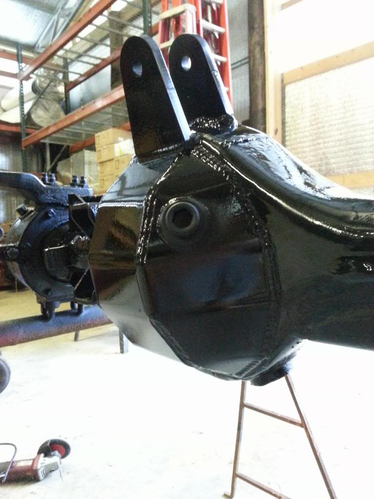

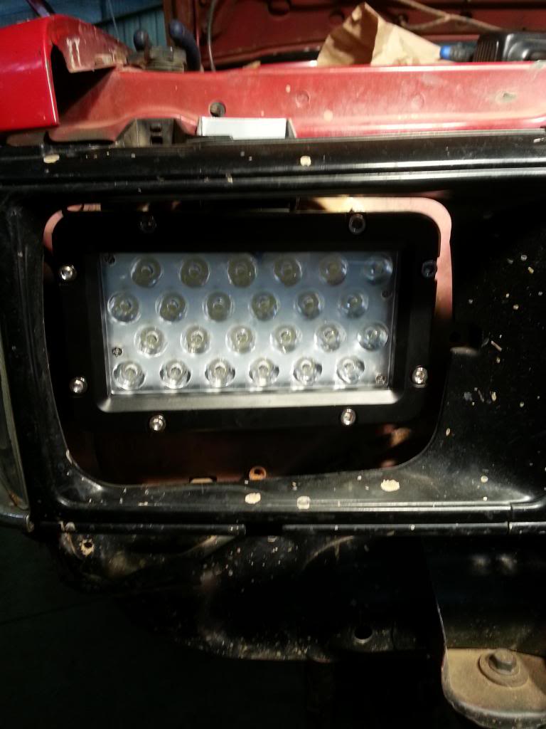

got my axle back from marsfab he welded the barnes cover ram mount and knuckle gussets on and did a great job ill post some up of that tommorow after i paint it his welds always impress me. heres a little side project i did that turned out pretty cool im ready to test them on the trail ai357.photobucket.com_albums_oo20_jrea42_toyotalights3_zpsce9f74d5.jpg
didnt even have to drill a hole and they lined up pretty good in the grill cant complain for $110 with nice wiring and all around great constuction
Yay somebody had the idea I had and did it before me so I could see how it looked. Looks like the runner will get leds for headlights.
its way cheaper than going with hella housings and hids i like it

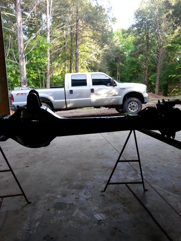

got to axle painted and installed i know i need to work on the geometry some but i like this alot better than before
and under the truck
thanks barnes 4wd for a great product i dont know of anyone else with a piece like this and chris at mars fab for the great welding job

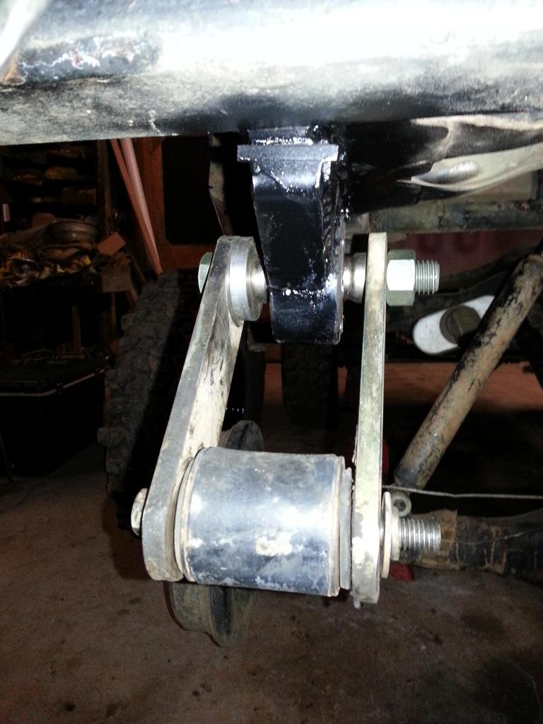

Redid my rear shock mount to raise it and not bottom the shocks out and did balistics 3.0 flex joint shackle mounts ai357.photobucket.com_albums_oo20_jrea42_20131014_191319_zps181dd001.jpg

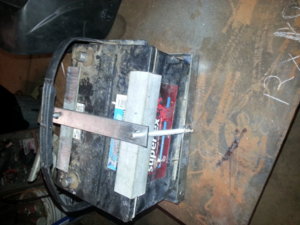

Also built a battery box for my group 65 battery i had shoe horned into the stock hole, ill be buying a deca when i have an extra $150 layin around
