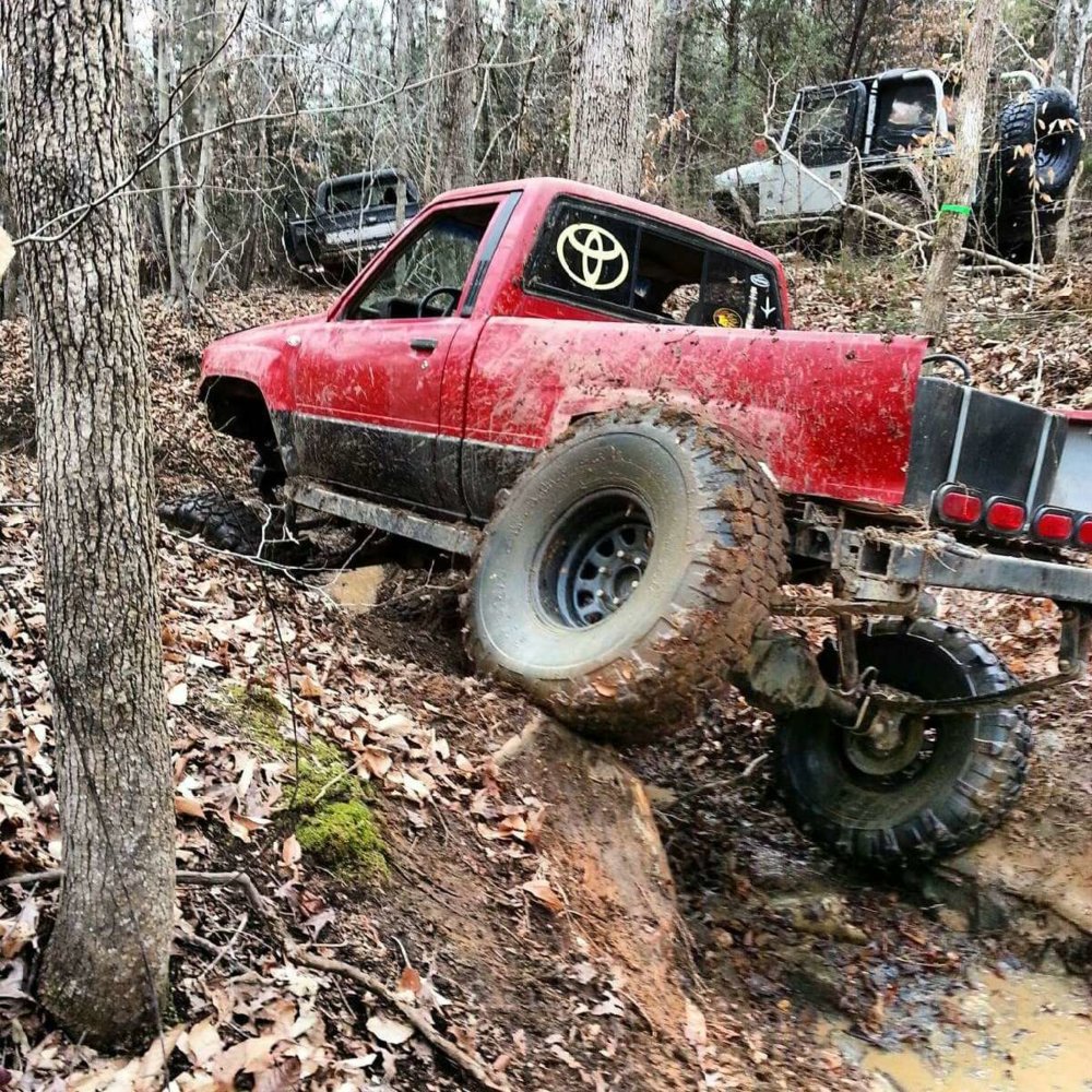

Honestly... I have no clue what I have in mine. I started with 4" yj's but with the axle pushed so far forward I had horrible shackle angle. I had a custom mail leaf made that is a cross between the 4" yj, from the center pin forward, and a toyota rear, center pin back. One thing I noticed with rears up front was the axle is at a bad angle. That is why I had a main leaf made... Next... Lol, I took an arched 4" yj spring, a rear Dakota spring, a couple rear yota springs an maybe another one... I think I have 4 or 5 leafes in it. I will have to look. Honestly, mine is a little soft. It flexs pretty well but the front end has settled down a good bit.
