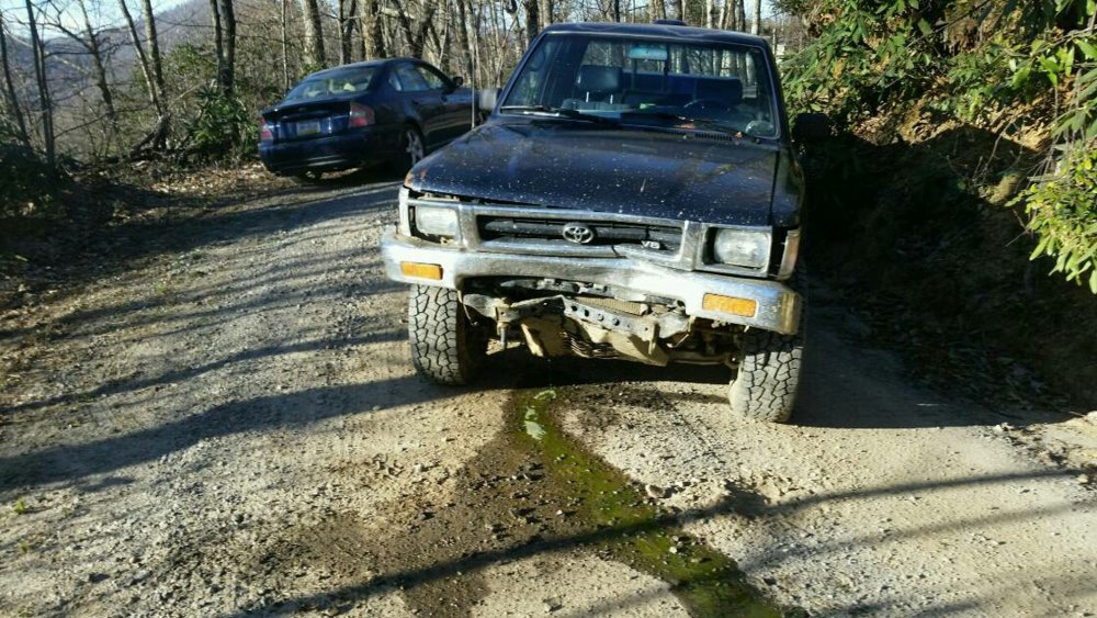

Still up in the air, but leaning towards RUF and some 63 Chevy's for simplicity and a quick turn around. As mentioned, its wheeling season not wrenching season.
Motivation for a leaf springs
