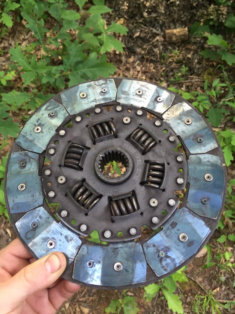

I always use the eddy/daken clutches there oem and work well for me that being said by buggy had a brand new clutch on it when I got it and it says China in big letters and has held up well
