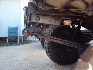

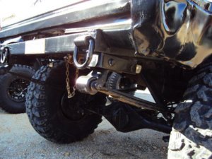

I didn't have to move mine back any at all. Will hunt pics of my setup.
