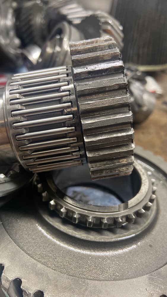

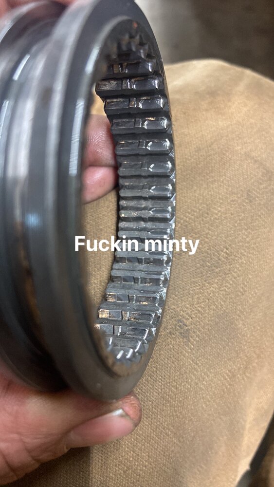

So I’ve found the obvious weak link in my rear case and since I’m down, I’m going all in. I ordered the marlin crawler competition 4.7 gear set. When I took it all apart, I found some issues that need to be dealt with. The output that’s in there is a TG but there is some damage to the 2wd/4wd gear, so I’m replacing it.
Here is the question. I currently have a trail tough rear disconnect….
Do I replace the TG output and keep the rear disconnect, orrrrrrr do I go with the marlin crawler beef and get rid of the disco? ( there isn’t a disconnect for the 30sp marlin output)

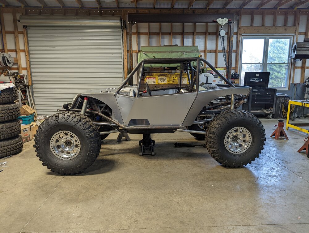

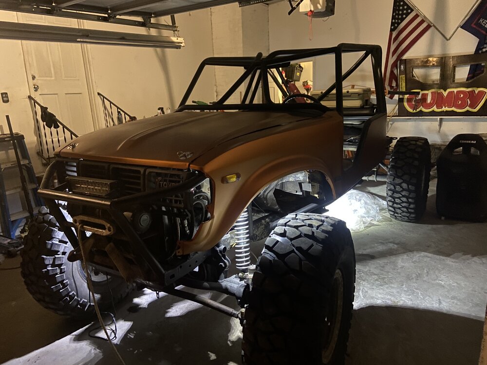

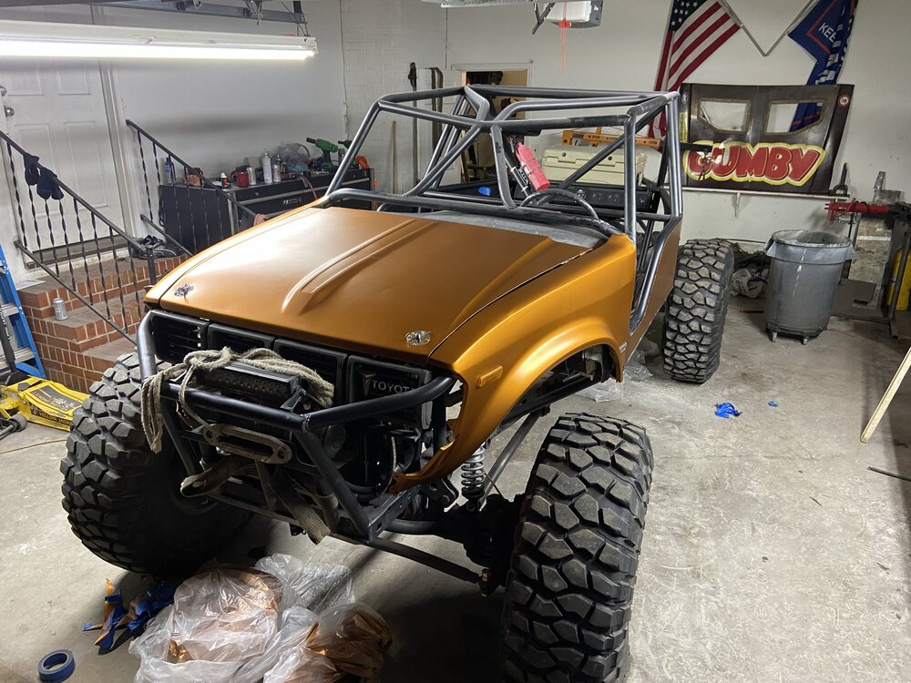

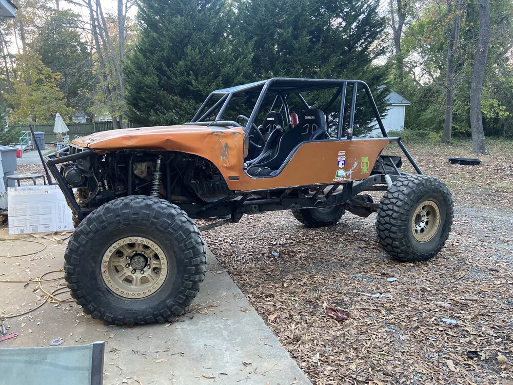

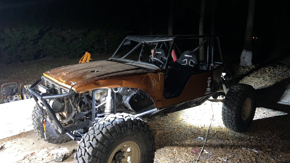

To be honest, I’ve never felt like I needed front digs in mine. But maybe it’s because I’ve never had that ability and I just don’t know what I’m missing. I’m at 115” wb and on 42” treps. Pic of rig for reference:

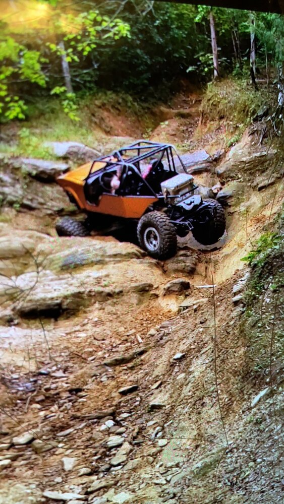

I been gettin stupid lately, I was up on a nasty hill and literally pivoted around a huge rock and came back down. The front dig is fuckin awesome!
