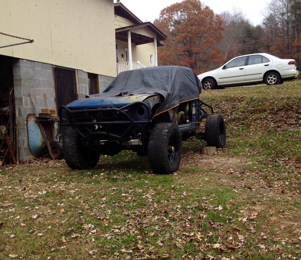

I'm trying to do a sping-under first gen. I'm using some kind of all-pro lift springs (truck was running 38's in SOA configuration) and a full-size jeep dana44 (already has SUA pads). The axle was originally narrowed 4" to fit under a CJ, so we just had to tweak the spring pads to fit the toyota. It's currently sitting on 33's, I am having clearance issues with the steering, and I do not have an engine in yet but am sure that oil pan clearance will be another issue. My tire size goal is 35-37" using these springs and whatever cutting is necessary.
Also, was originally a 2wd truck.
