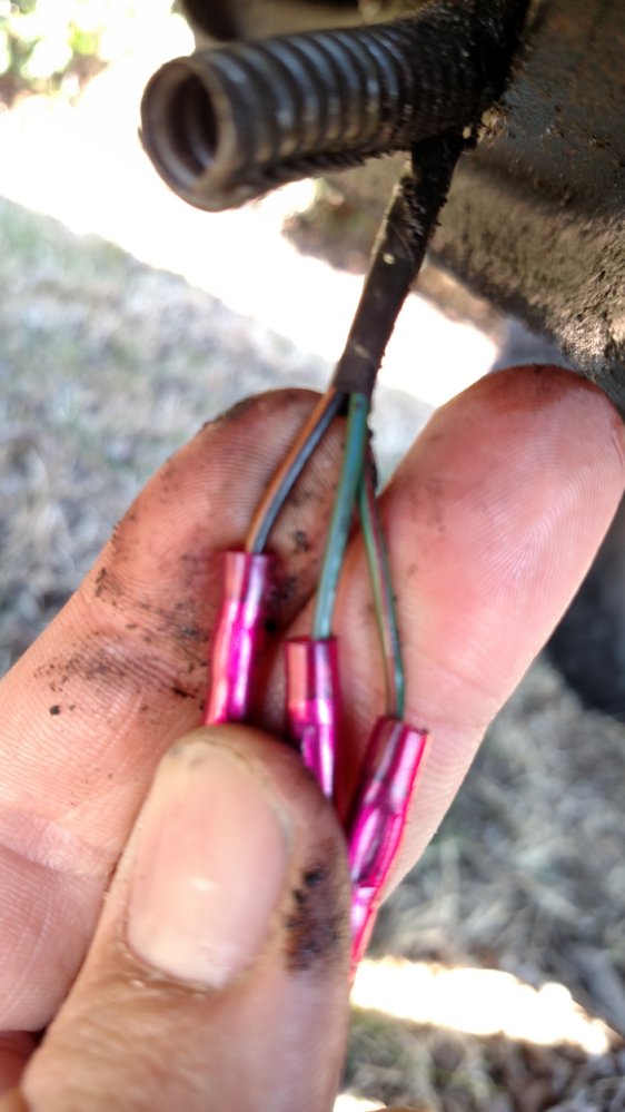

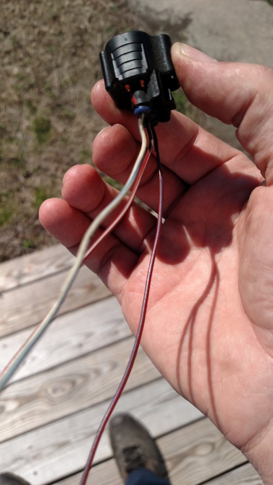

I have recently acquired a 1993 Toyota 4Runner. Has the 3.0, SAS, and has been converted from auto to a 5 speed. My question is there is an electronic speed sensor on the back of the transfer case that has three wires. The wires on the transfer are colored white/blue, red/blue, red/white. The wires coming from the truck are black/orange, and two other colors I can't remember off the top of my head. Can anyone tell me how to hook these wires up to get the speedo working correctly?

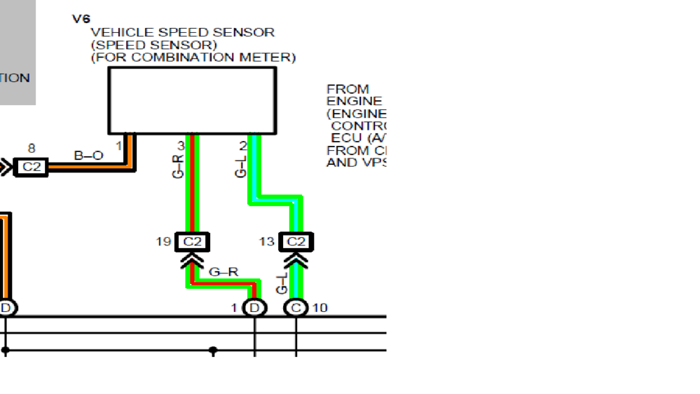

any chance thers some more wires? or some pics of the wires? None of the factory schematics are showing those colors for speed sensors
red/blue and red/white are normally reverse light switch
Truck wires are the bundle with the black and orange wire. Transfer case wires are with the blue and white wire. There is one other plug that is 2 prong.
there should be tiny numbers on that tcase plug.. match them to these
