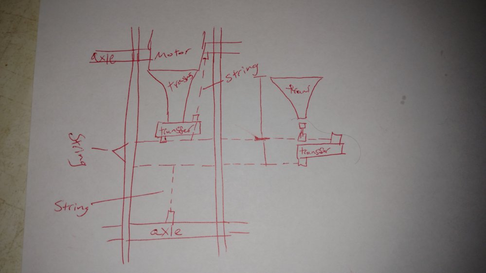

If it where me since it sounds like you have the 2wd tranny and the 205 I'd lay them about with the distance you want them apart from one another then measuse from the Bell housing back to the yokes on the 205. Then figure out if your gonna clock it or if you can and figure out how far the yokes are going to be from the bottom of the frame. Then measure from the front of the 4wd tranny in the truck the measurements you took and run a string at that point from one side of the frame to the other, then drop down how ever far the yokes are going to be from the bottom of the frame rail. Then run a string from that point to the axle yoke and measure, and find the angle of the drive shaft at the trans and axle on both front and rear and then post those numbers and angles up. Someone on here will be able to tell you if those are usable numbers before you ever start on trying it.
Reread that and it's kinda hard to fallow. So here is a ruff sketch of what I was trying to say

I think he needs it longer than what it is now? Did you read what I said and did it make since? lol

Okay glad it made since somewhat. Also I'm sure you could get someone on here with a Toyota doubler to pull the same measurements to compare to the 2wd and 205 numbers
Yeah if someone wants to post some numbers for me id appreciate it. I'm really no expert with this stuff quite yet but if anyone lives near asheboro that can help me out I can bring the truck over and some beer for your troubles :flipoff2:
