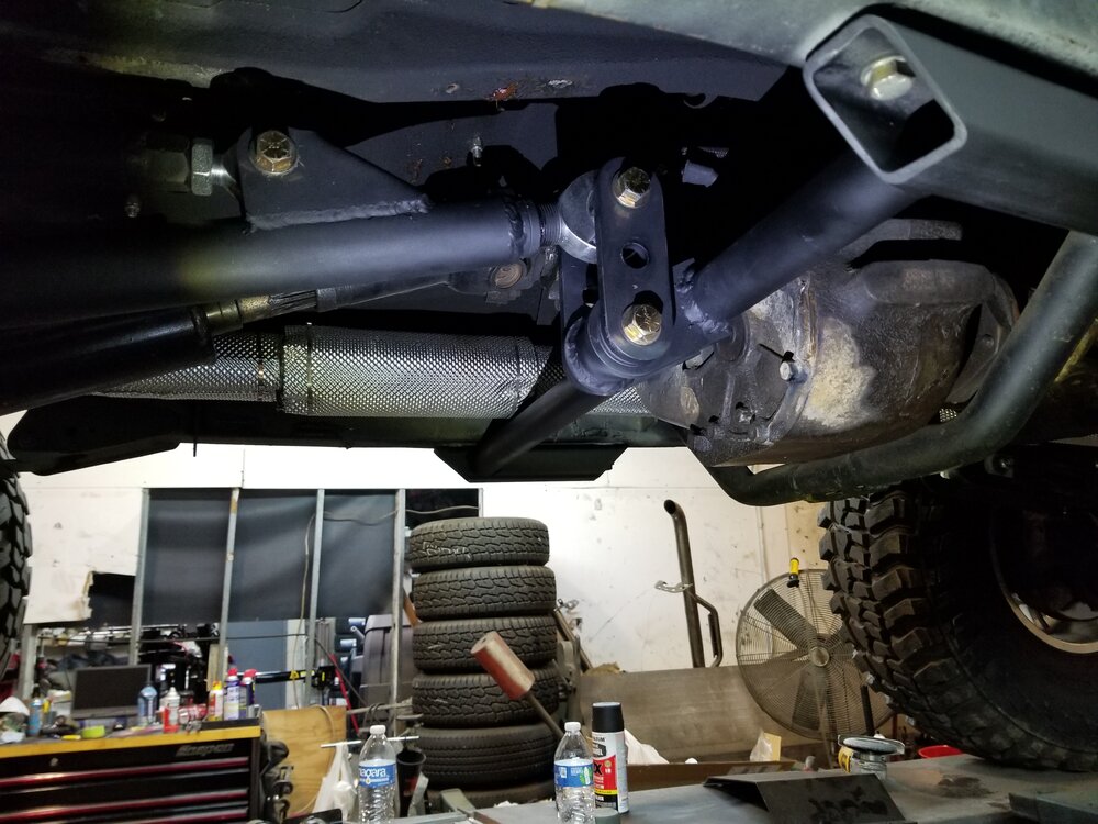

I'm semi-convinced the Rover control arms make great anti-wraps (have seen 4-5 setup that way, not including mine).
Rides over/above the axle, much better clearance, and less likely to snag... the only thing is doesn't do that my old MORE bar did was offer a little bit of driveshaft protection... otherwise it'd be perfect.

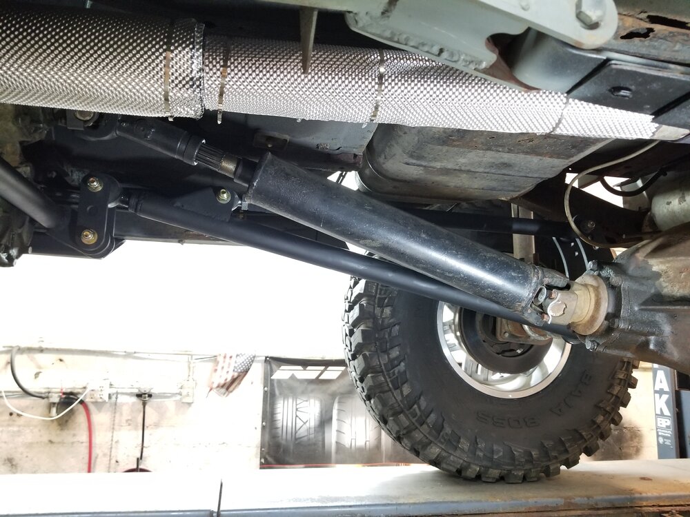

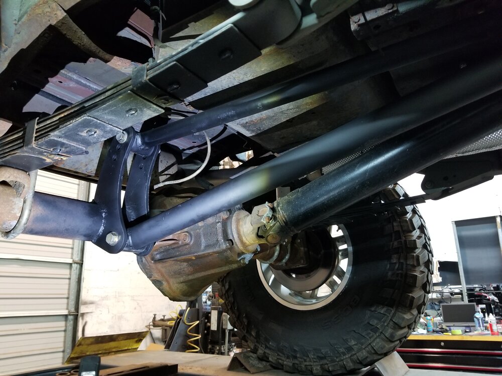

I'd like to see pictures of this. I'm not sure I understand. I did a slip and twist over the axle pumpkin. 2" x .25 wall square with a 1.5" I think round solid rod. Doesn't limit flex and stops the axle wrap.
Best I have until later, but... you can see how the control arm attaches to the axle and the lack of anything hung below the housing. The front is a combo of johnny-joint & shackle (like everything else). @R Q ran it in his Jeepster prior 4-linking and the 9" (was in a Cherocar) was setup for the same CA/traction bar, so was bolt-in

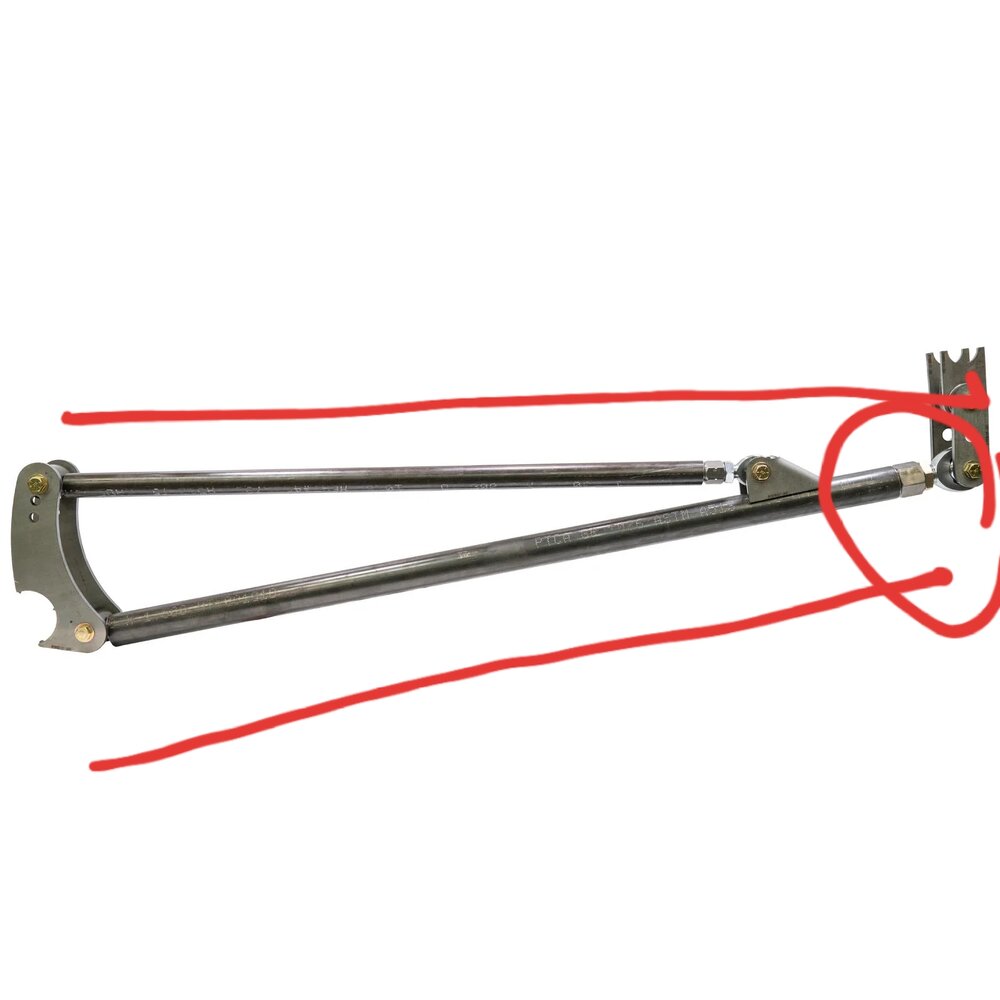

Question for someone smarter than me (that's anyone) with this traction bar do I want the centerline of the 2bars to intersect at the joint?
Question for someone smarter than me (that's anyone) with this traction bar do I want the centerline of the 2bars to intersect at the joint?View attachment 426724
Functionally it makes no difference. They are acting as a big fixed "L" and the only purpose of the upper arm is to adjust the angle and translate the torque load back into the lower arm via a fixed triangle shape. The strongest configuration would be for them to meet at the joint, as that eliminates any bending load on the main arm caused by the torque on the upper arm. It could also be built as a fixed bracket on the axle end with no upper arm, so long as the bracket and arm are strong enough to carry the load. Point being, do whatever is easiest for the packaging constraints. Also, I would recommend to have the joint inline with your front spring eye to eliminate any binding.
