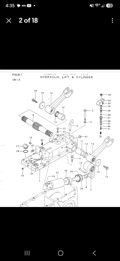

3 point on my mitsubishi 3 point lift. The lift just randomly stops working.
I just took it all apart cleaned it and replaced all fluid although it was clean last weekend. Was scrapping my driveway today and it just stopped lifting up. Tried it with draft control both directions so its not that. I just replaced part #25, #26 and #39

Finally had time to tear into this. Found a pretty good scrape on the inside of the cylinder part #23 and part #24 the piston had some scars. Found a used one on ebay for 100.00 so going to see if that is the issue. Pulled everything apart and drained fluid it was all clean no blockages I could find. I pulled the pump and it looked fine. Didn't think that was the issue as it seems to be pumping strong.

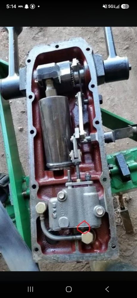

Drained the fluids from the tractor, changed the full fluid cleaned the filter again wasn't dirty. Put the new piston in, bleed the lines... ive got nothing. I went back and looked and ive replaced the hydrolic pump in 23'. So tbunk that is fine.
Only thing I didnt do is replace the o ring on the piston. But it didn't look bad. And I didnt push out the piston from the cylinder now im wondering if the piston is to far into the cylinder for the fluid to push it back out. But that doesn't make sense really.
does this have a system relief? maybe it's cracking and dumping the pressure?
Okay just updating this. Drained and cleaned the case and filter, wasn't to bad dirty but did that anyway. Cleaned relief valve and the control valve. Changed the lift cylinder as mine had some pretty good scoring. 3 point is working now but extremely weak. With it up i can stand on it and it will lower.
Only thing I can think of is the hydraulic piston o ring is shot or I put something back together wrong.

Tore the control valve down again. And the ram. Replaced all the o rings on everything. Slightly more more than yesterday but still no where near where it was
