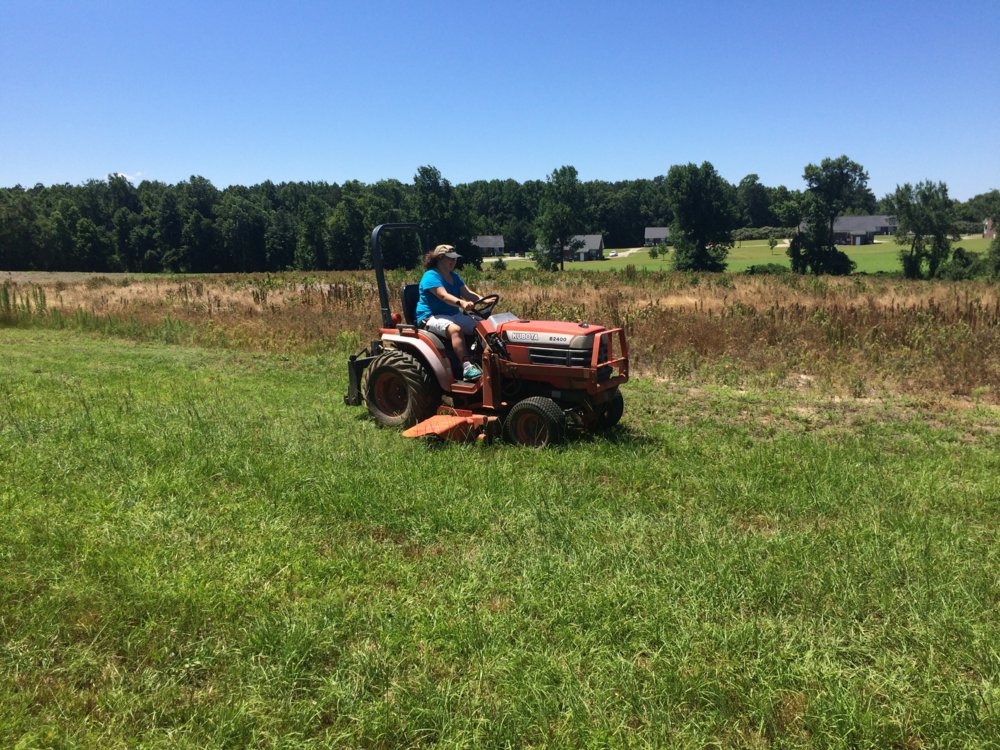

mowing trim

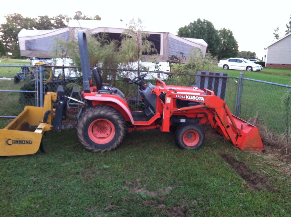

if you have a lot of smaller trees, or shrubs, this isn't the type of machine you want to mow with, you're better off with a ZTR or lawn tractor, if you want/need a loader, you'll be getting a ROPS ( roll over protection) as well, the loader can cause instability when raised loaded or unloaded depending on terrain. if you get a loader, also get 4wd, it helps a lot, you can always not use it, but damn sure nice to have if you do need it ! 4wd is also nice to have using box blade
another thing to be mindful of, old machines need repairs, and other consumable parts like tires. the front tires on mine have been discontinued, as have the rears, on a 4wd machine, just tossing on any ole tire can get real expensive. after some careful tire selection for the front I came "close" to what it had, and use air pressure to account for the rest. they're slightly under inflated to decrease roll out slightly. I don't drive in 4wd for extended periods, just where needed and only in loose conditions where tire spin is expected. Rear tires are on the horizon, just need to pony up ($$$)

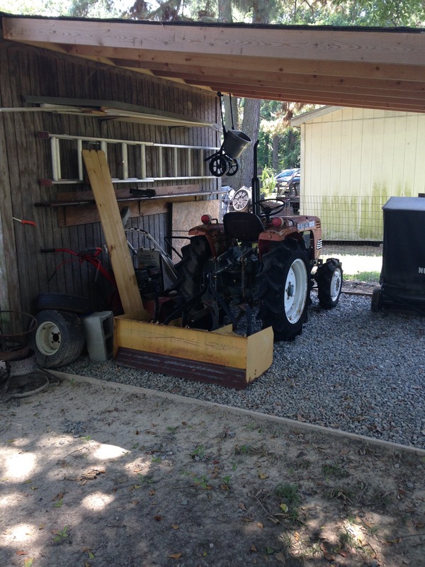

I have a diesel Shibaura SD1540 (Shibaura, a Japanese company, makes New Holland and Ford tractors under 30hp). It is 4WD and has a track of only 48". It's a great size with great power and while I wont be pulling an 8 row disc with it, it does everything I need. I got it WELL under your budget. You just have to look.
It also has 4spd trans with hi and lo, 2spd PTO and diff lock.
