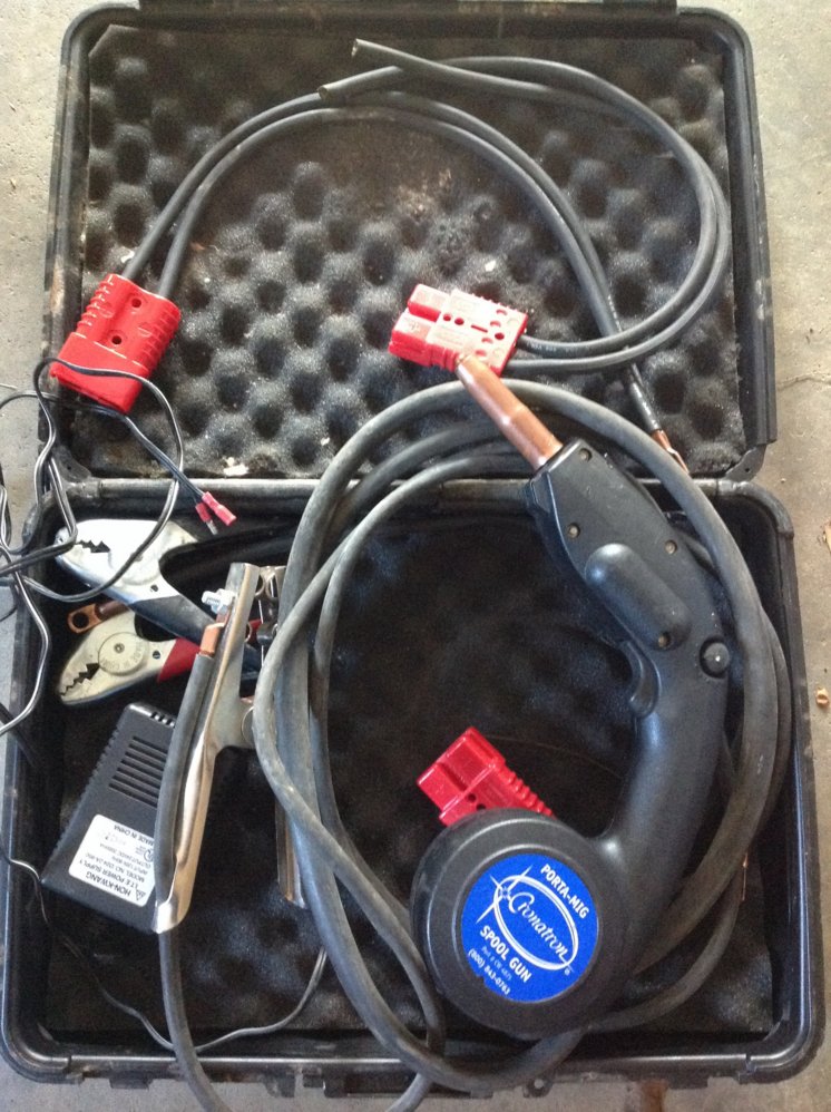

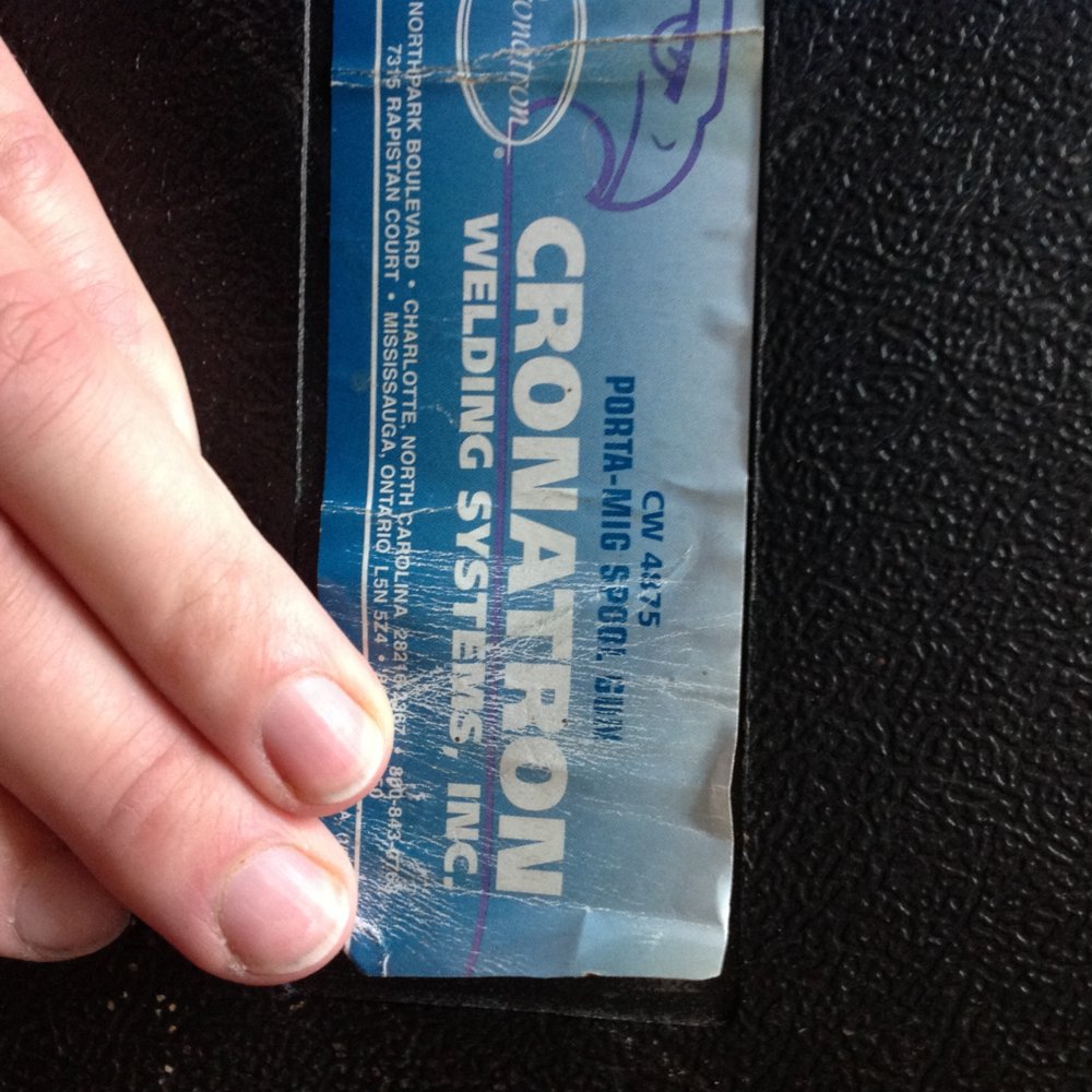

anyone know anything about this? Was made in Charlotte/ China, but out of business now. Was told you hook up to two batteries for 24v supply. Google can't find anything. Cronatron CW 4875. Would love to find an operators manual.

Yes, I think it is a rebadged ready welder. The cable to the gun says ready welder on it. With the inverter looks like I can run it off a stick welder maybe. Hopefully I can do aluminum with it. Any experience with ready welder and aluminum? Do I need anything else? Thanks
You'll need to have an argon bottle, and aluminum wire. I hadn't welded aluminum with mine, but a friend has. HE only used it for repairs, not to build anything. He said 12V, and be ready to weld fast!, So, I would reccomend some practice for sure.
ANd yes, it's a re-badged ready welder.
