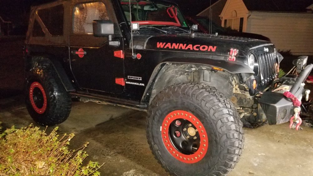

I'm running TMI DIY rings on 17" steel wheels. I spent about $380 with HW and shipping for a set of 5.
They added about 15 lbs to each wheel but so far, they have been great. They hold air just fine sitting in the garage. Conventional balancing with all but one needing a few oz or weight and the one that needed a lot is most likely due to not aligning the tire correctly in the wheel. The biggest thing is to have done a good job on wheel prep, have a good welder do them and use some silicon on the bead to ring.
