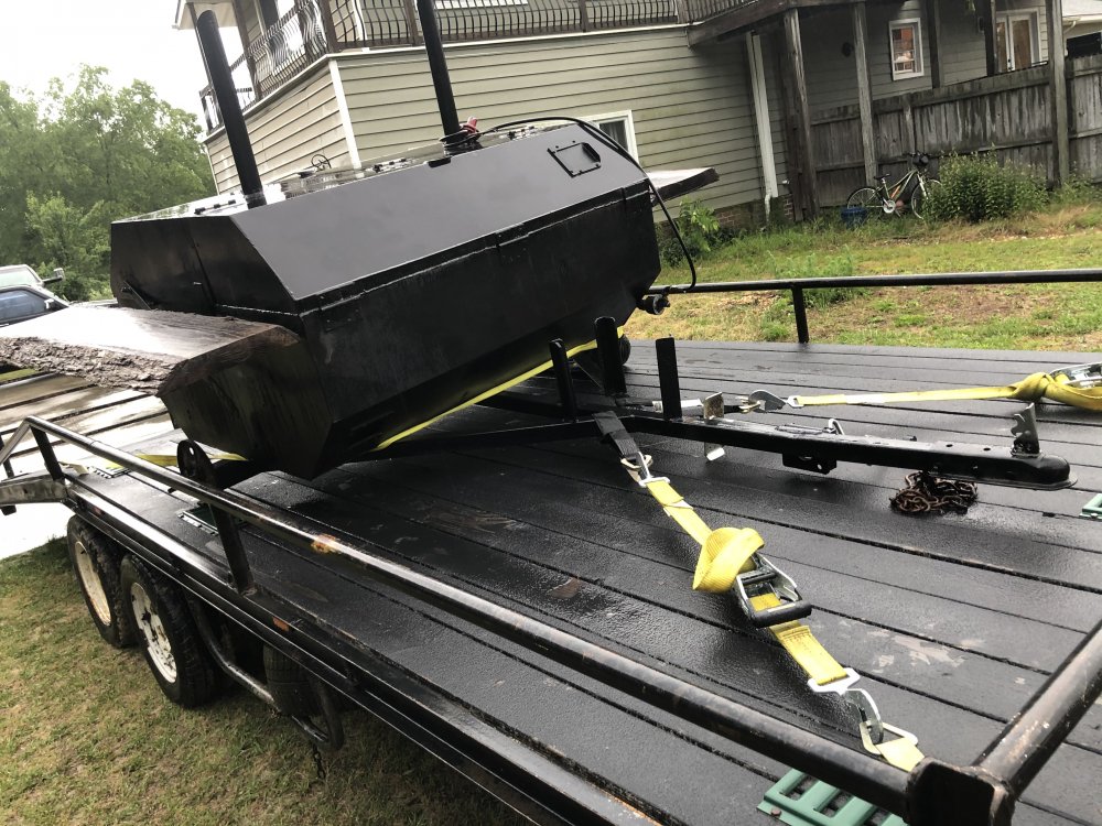

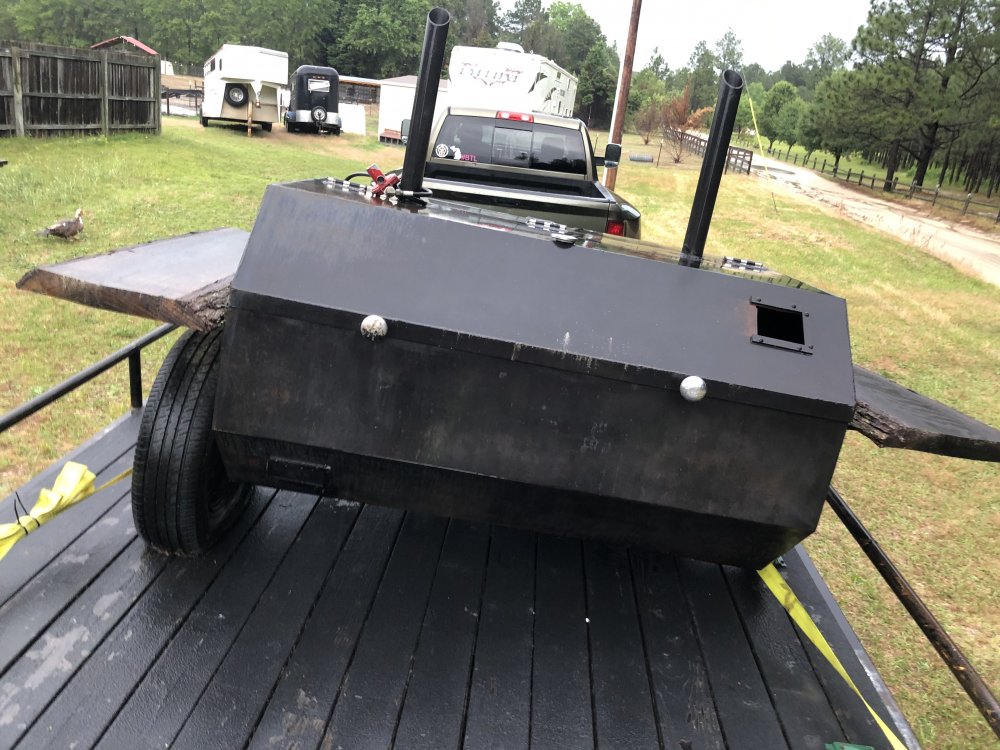

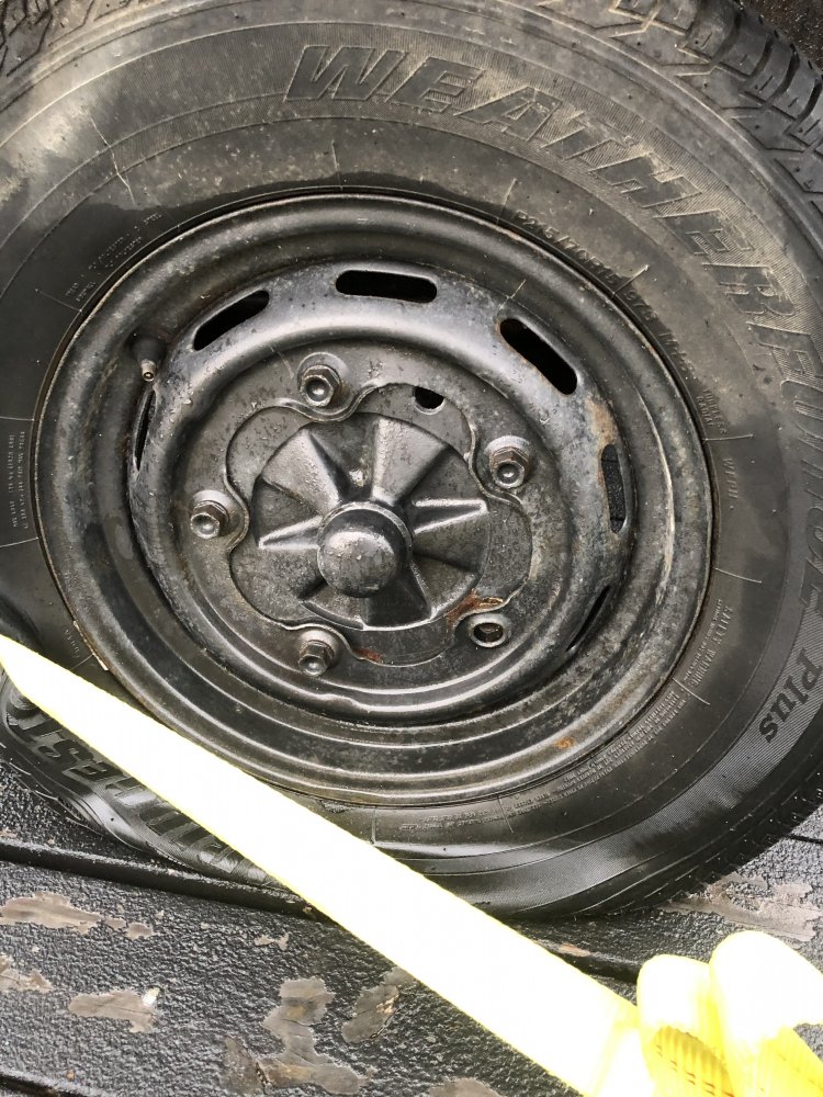

I received a free pull behind bbq pit because the wheel and bearing assembly exited stage right while going down the highway and dooder doesn’t want to fix it. Overall build quality is good and it’s fully functional on either propane or coals. Originally the axle was a 4” square tube welded the width of the smoker with what look to be spindle/ Hubs/ brake assembly from some sort of European car hacked off and welded to the ends of the square tub. The axle assembly is an abortion to begin with so it’s going to get gutted and I’m going to just buy a cheap axle/spring setup from tractor supply and start fresh.
Question is, does this need lights/tag? What are the rules for this type of “trailer”? Pics to follow after this latest deluge has passed us by. I’m not trying to sink money in it more than getting it mobile and cooking dead animals on it!
