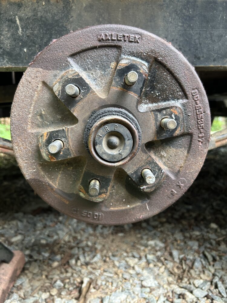

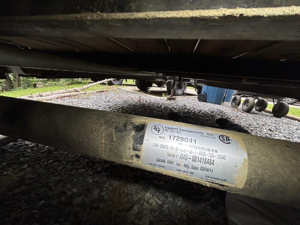

I’ve never replaced trailer bearings or hubs, just greased them.
Checking out my trailer today because I’m heading to Kairos later the week with the CTB.
A couple of the wheels feel like they have more play than they should.
I’ve been searching using all the numbers on the axle tag, even on Lippert’s webpage and not finding anything that makes me certain of what parts I need. These are 4,000 lb axles, which apparently are a bastard size that nobody wants to admit to.
Any smart trailer people out there that can point me in the right direction for parts? I’ll call Lippert Monday morning, but thought I’d check here.
Also, how much back and forth play is too much?

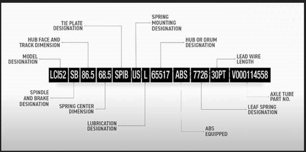

Here's the lippert part number breakdown which will get you everything you need.
Interestingly enough thats an RV axle
Our travel trailer had oddball designated Lippert axles in it. They were rated for 4400 pounds. I eventually figured out that it was mostly 3500# axle parts with a 5200# outer bearing and race being the only odd piece.
