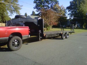

No it is a 23ft deckover. Does rednek not have prices on they're website? I appreciate everybody help and input. Here is a picture of the trailer.

I am unsure how old they are as I bought the trailer used in 2010. i didn't measure thickness of shoe but it was at least a 1/4 inch of meat on them.
Oh yeah, those will last forever.
