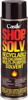

the first is my go to penetrate, the second is my go to solvent (even to prep aluminum to TIG weld) zero residue.
Prep steel for welding with this too? I been dumping acetone in sprayer bottles... lol
You could....unless its drenched in oil or I'm GTAW welding I don't get crazy with steel. But I do remove rust and mill scale.
