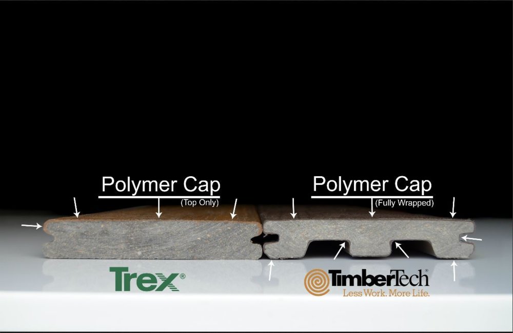

I use Trex decking on mine unlike you peasants.
I use Timbertech because baller
How do you like it? I find the Trex to be a bit stiffer because of the full cross section, but I could see how you would need the reduced weight of the Timbertech with your neutered Cummings
