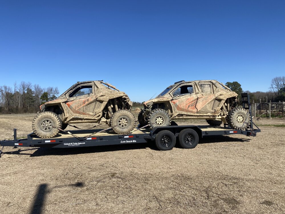

I have some friends that just stayed there. They were really pleased. We have a place in Welch so we mostly ride around that area except the few times a year we ride with our big group. Not sure how good the rock lights on the machine would shine thru all the mud, lol. Most trips back ours are rotten. We did a little over 300 trail miles last trip over 2.5 days. I guess this shows I took you guys advice, sold the small trailer and just bought a 26 footer.

From looking at that, maybe mount a pair under the rub rail and drilled through the upright brackets. Then possibly in front of and behind the fenders like I mentioned earlier. I think that would pretty well cover all your nocturnal luminescent requirements!

Is that front rail solid? Put some flush mounts in it so they can't be hit from the front.
Like @shawn said…. On my previous trailer, I mounted a short (8”?) NiLite LED bar onto the crossbeam maybe 1 beam behind the rearmost axle. It was wired into the reverse circuit and lit up the world. The location protected it from rocks and avoided clearance issues. I’ll do similar on my new trailer.
Regarding deck lights, I have a pair of NiLite 2”x2” led work lights to mount onto each side of my headache bar. I’ll wire them into the 12v winch battery so they’ll be available any time and keep the battery charged using the engine‘s charging system to keep it topped off.
