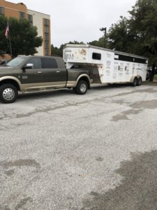

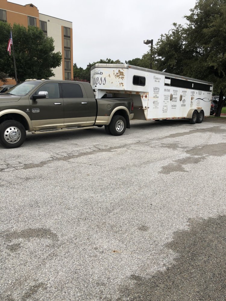

I have completed all the necessity items on our “new” stock trailer including wiring, brakes, tires, and checked/repacked the bearings. The trailer had a bunch of vinyl lettering which I have removed and I would like to paint the trailer at some point although not a huge rush. It lived its former life in Oklahoma so no rust to fix but the paint has seen better days. My thoughts are to go over the whole exterior and rough sand it then give it a heavy coat of white rustoleum tractor paint. My questions is, if I buy it in the gallon can I roll it with a foam roller and expect it to lay out decent? I know some people have had good luck spraying it with a HVLP gun but I have no place to do it inside and don’t really want to buy a spray gun either. I’m not looking for showroom finish just a good ten footer. What are my options? DF4F3B1C-9391-4D95-B8C7-228C876B537F.jpeg

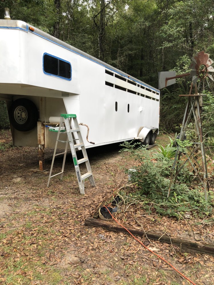

Well I started working on it. I used whizzy Wheel to peel the vinyl lettering and an orbital sander on the whole trailer with 120 grit paper. I’ve got 3 coats of rustoleum gloss white oil base on the driver side and nose (Lowe’s is switching to krylon so the rustoleum stock is on sale). Gonna tackle the passenger side this weekend. So far it’s laying on nicely and finishing like glass. I didn’t thin it. I just put it in the pan and rolled it with a foam roller. Used a foam brush to cut in and get in the nooks. Gotta put the side vents and the fenders back on once finished. Someday it will get new fenders cause these are pretty tired but they’ll do for now with a bit of straightening and some polish.
