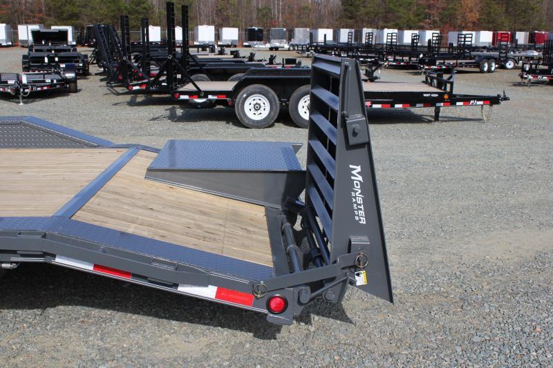

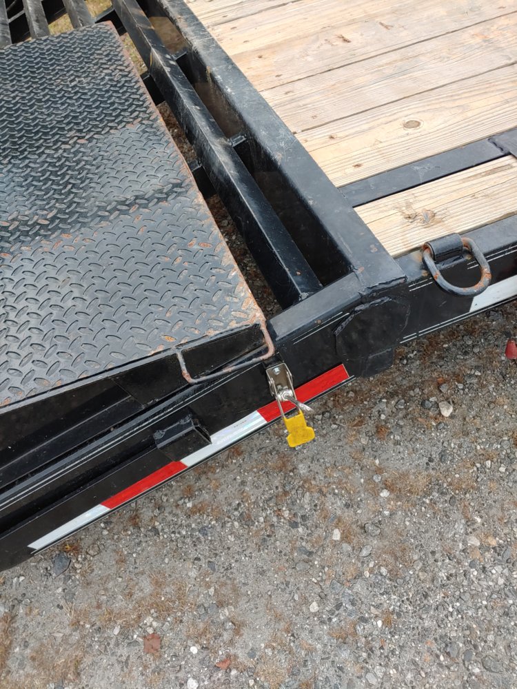

I know it's pretty specific but has anyone come up with a better solution than these $60 turds that keep breaking for holding the ramps down?

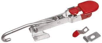

Okay, here you go:
- Click here: McMaster-Carr
- Click on "Draw Latches"
- Scroll down to "Weather Resistant Draw Latches"
If those can't handle the vibration and movement you need, then the latching aspect is not the actual problem.
Buyer's Products also makes some universal rubber ones for truck hoods that are very similar and quite cheap. Hood Catches and Latches | Buyers Products
If you're going to use something similar to what you already have, you should get a "hold tight" version that has springs built in. But I'd really recommend the rubber type that I've linked above, which can handle a lot more relative motion because they're rubber.
After load trail wouldn't send me any more latches, mcmaster is where they have come from. I was envisioning jeep hood latches when I posted this and the buyers products' version is probably the ticket.
They won't flip over when not latched but they make a hell of a lot of noise and scare small children, women and dogs. And drive me crazy.
Or an old hotel pool towelPut a rubber pad on the trailer. Just a couple well placed pucks. Or even HDPE or something.

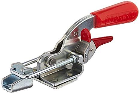

Would this style of Pull action clamp work.
$30 on amazon
PJ Trailers are pretty pricey but they seem to have solved this issue with $40 in material
