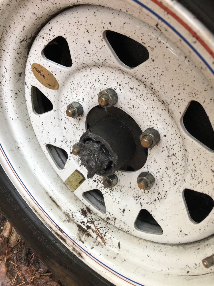

So I went to go get my trailer this weekend and apparently I was lucky I got it back to storage the last time. Looks like a blew a bearing. I have always used Colfax trailer, but looking to see if there is a place closer.
Looks like you lost the dust/grease cap.. Trailer bearings are easy to do.. Jack it up and see if you got play in the wheel bearings. If not, get a new cap and roll out.
lots of play in the wheel, but honestly haven’t had a chance to investigate further
Boy im glad it has a sticker to let me know that thats a wheel! Never woulda guessed!!!
:D Never even noticed but right there with you hahaha, I guess that’s what you get with Chinese pieces of junk
If the hub is not damaged from a loose/broken bearing race or whatever, RockAuto has the Timken race/bearing sets for really cheap. You just need to find out what set you need, and search by part number (Set 17, etc).... I think the Timken sets for the boat trailer are just over $5 each, so I can do bearings and races for both hubs for about $23 total. Plus seals.

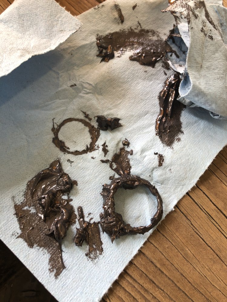

It is all back together, it was more than just the dust cap. The bearings were basically gone, the picture below is the largest piece we found when we opened it up.

When you said the dust cap was gone, and there was lots of play in the wheel, there is no way I would reuse the bearings even if they looked okay. Not worth messing with possible bearing fatigue (from a lot of wheel slop under load) by reusing parts when new parts are so cheap.
Also, grease compatibility. Incompatible greases will often turn each other into liquid, or into a hard clay of sorts, so just clean everything out of the hub if you're not sure what's already in there. Grease is cheap.
For example, you can often buy lithium complex, aluminum complex, calcium sulphonate, and sometimes polyurea bearing greases all in the same isle of the parts store, and some of those are completely incompatible with each other.
For example, you can often buy lithium complex, aluminum complex, calcium sulphonate, and sometimes polyurea bearing greases all in the same isle of the parts store, and some of those are completely not compatible with each other.
That's a level of greasiness I can get behind. Never new this about separation and or dissolving each other. Being stubborn with cleaning out parts all these years has inadvertently been a good thing.
