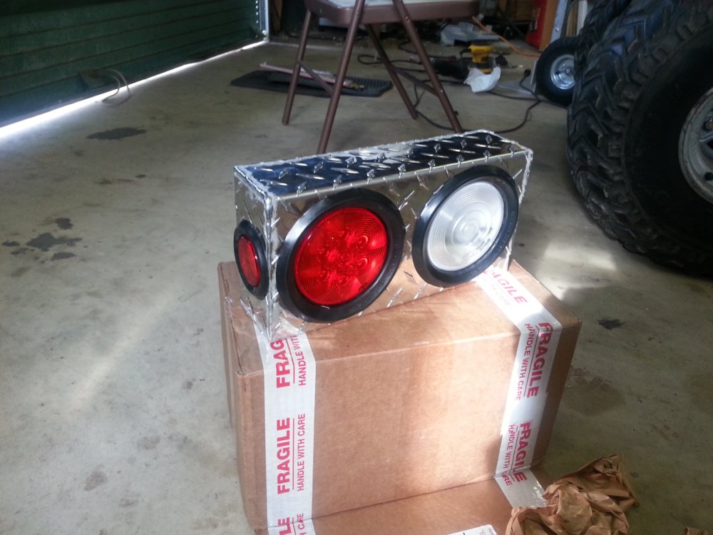

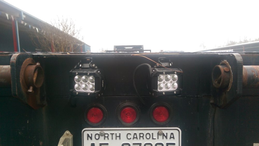

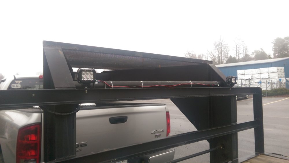

If you don't already have them, led flood lights wired to the reverse light pin make backing at night much easier.
I used these for backup lights:
Amazon.com: Nilight LED Light Bar 4PCS 4 Inch 18W LED Bar 1260lm Flood Led Off Road Driving Lights Led Fog Lights Jeep Lighting LED Work Light for Van Camper SUV ATV ,2 Years Warranty: Automotive
And, given the choice, I like the idea of running one brake wire down each frame rail, rather than one wire that daisy chains around. It is more resilient, and there's less current on the wire at any given length, which should help a bit with voltage drop.
Those are exactly the lights I was thinking of. I've got them on my trailers, and two are mounted under the bumper of my truck. The bumper lights are hooked to an upfitter switch in the Ford so I can switch them on independent from reverse. Makes it nice hooking up a bumper pull in the dark.
The rear set runs through a three way switch, so they come on with the reverse lights, or I can flip the switches on the headboard and have them on all the time.
