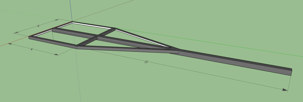

The basic design is going to be a 4 x 4 square to hold the axle and support the rear of the trailer this we made out of 2 x 2 .25" angle. Then there will be a support running from The corner of the square to halfway up the rest of the tube. The tongue will extend all the way to the back of the trailer

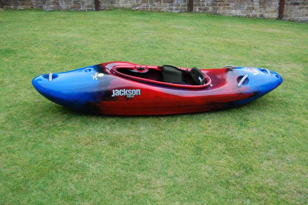

Fail.
That's a touring kayak. A creek boat is more like 7-8'. Like this.

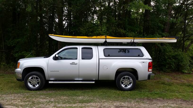

The shell does not stay on my truck. If it did wouldn't be a need for a trailer.

Below is a quick sketch of what's in my mind.
If the main tongue is really going to be 15 feet long, I'd go with something less noodle-y than 2" tubing. Step up the size, go with a thin wall, and you'll have a much stiffer tongue than you would with a thick wall 2x2.
There's not going to be much weight to put it in bending but it's still a pretty long unsupported free length.
Ah, whatever. 2x2 is probably fine, even thin wall.
Yea, I'm thinking that the 3x3 is what I'm going to go with. It will be better in the long run. In the above drawing it is a 3x3.
2x3 would work as well, you don't need any extra stiffness in the lateral bending direction so you can save some weight that way.
Where is the axle going to be placed relative to the C of G of the boat?
Axle will be at the back of the trailer. centered in the 4x4 section. I don't know if there'd be enough tongue weight otherwise.
Seems like the tongue is just begging for a gear box of some sort attached to it. I know you don't need one with a pickup truck, but I look at that design and the empty space just kills me! Looks like it would work fine for what you want to do. I like the suggestion of 2x3 .120 wall, but whatever's cheap should do the job.
I'd use 2x3 .120 wall to help against torque and to get tongue strength without going overboard with weight. I don't think there is anything wrong with 2x2 .120 wall or the 3x3 either.
