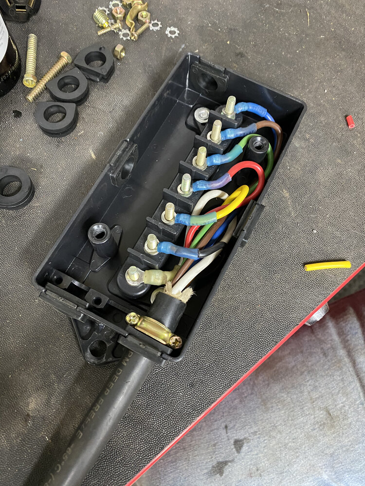

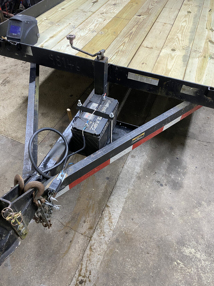

When I rebuilt my trailer last year I went wired in route. I think its cleaner IMO. I used biggest battery I could snag and wired it in for constant trickle charge from the truck trailer wiring. If you have trailer brakes, also a great way to ensure they are gonna get power.
