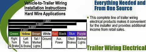

Here's a standard diaghram for trailer wiring, in case you need it.
