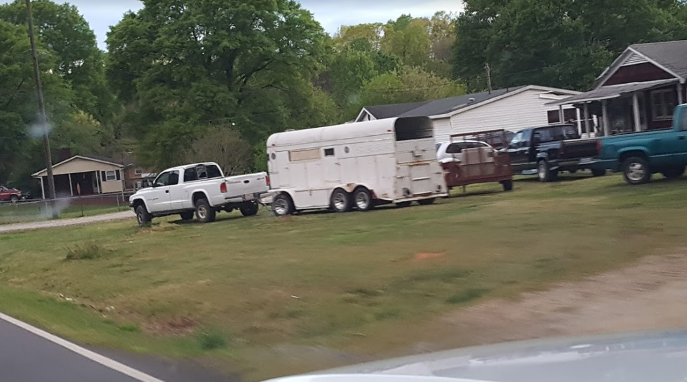

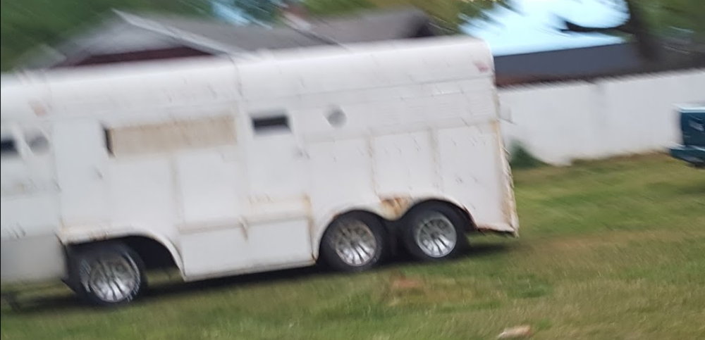

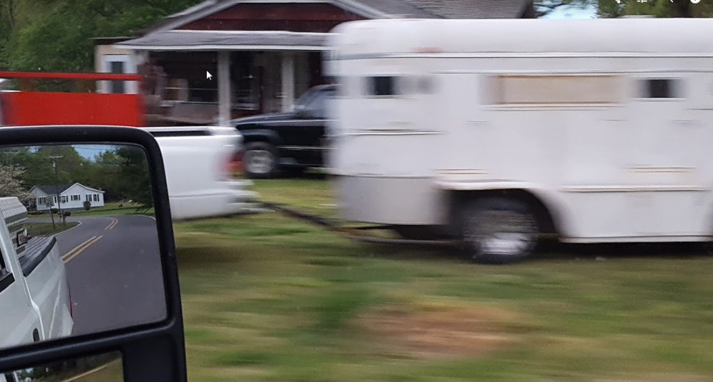

Sorry for the crappy pics, but you get the idea.
Reminds me of one of the dollies to pull a gooseneck like a tag along. Except, that looks like it was built that way. Definitely a WTF

My mother is a horse trainer and I grew up at horse shows every weekend. I had never seen a trailer like this so I screen shot the pictures and sent to her and was like “Mom, please explain this to me.” She said it’s a inline trailer, horses stand one in front of the other. Used to be very popular in the old days according to her. She said the front wheels pivot like a hay wagon.
It's a old wagon style trailer! Their kinda cool looks like a newer top on older frame maybe?? I've not seen one of those in long time never hauled one but bet it sucks backing up!
I pulled a hay wagon many many times during my first job when I moved up to OK...old bastardized contraption hooked up behind a 1950s Farmall H. After my first time, I thought my boss was trying to kill me.
That pile in the pic up there? I feel bad for the horses that have to ride in that b!tch.

Two answers...sort of, and it depends.
High quality definitely is a must, obviously. But other considerations are wheelbase, track width, COG, coupled with sway, speed, etc. etc. etc...much like any other vehicle. But vehicle sway (also increased by a higher COG, such as with an 8-1200 pound [per head] live load) is the biggest factor. I personally think that with the live (or some might call it dynamic) load, it would make pulling a trailer like that a little sketchy, high quality or not. Even pulling a regular bumper pull trailer (discounting the goosenecks since this thread has a wagon-style bumper pull) with 2000+ pounds of pissed off and/or scared sh!tless horses can make for a white-knuckle day.
