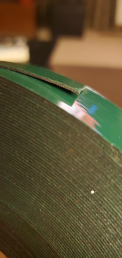

...maybe try to find some rubber or neoprene tape and put it on the racks that hold the ramps. I've got some 3M rubber tape that's only about 1/16 that sticks like glue to anything. It's also tough and has a backer that can be left on the top side when you stick it to something. You could also apply another layer to make it thicker. Then you would not have metal on metal noise.
