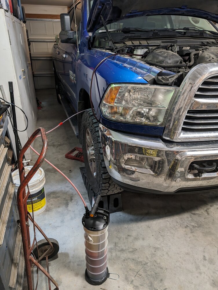

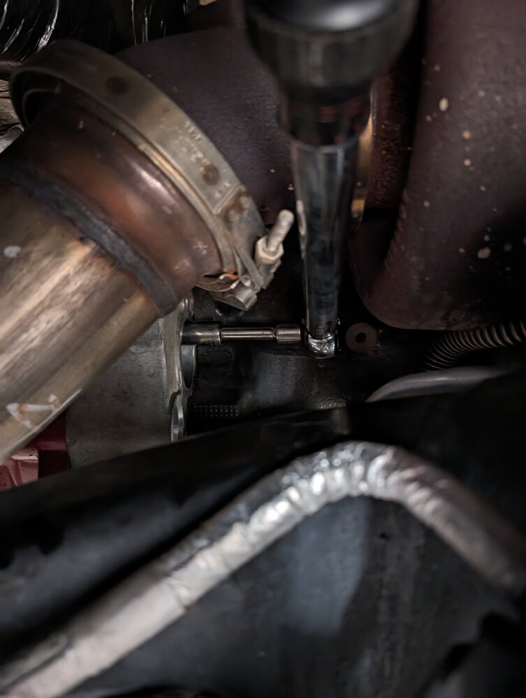

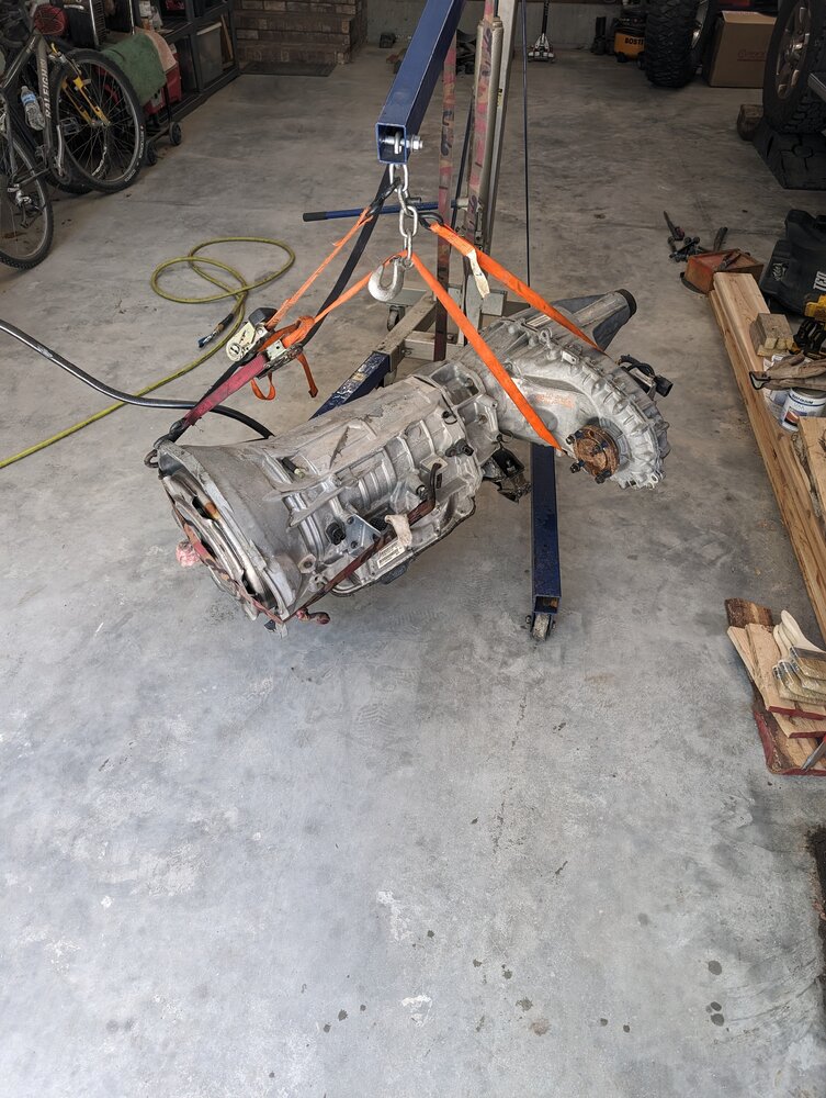

Took 5 hours to get the transmission out once I removed the def tank support, harnesses, and fanagled the converter bolts out the tiny blind access in the bellhousing conveniently hidden right below the turbo. Used my vacuum pump to suck the juice out:
Even with the truck on blocks the transmission wouldn't fit out from under the frame rails so had two floor jacks and blocks to get the transmission jack out and set the thing on the ground and then drug it out and used the engine lift from there.

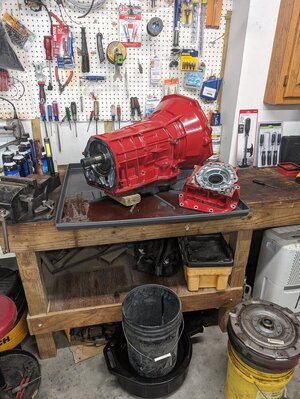

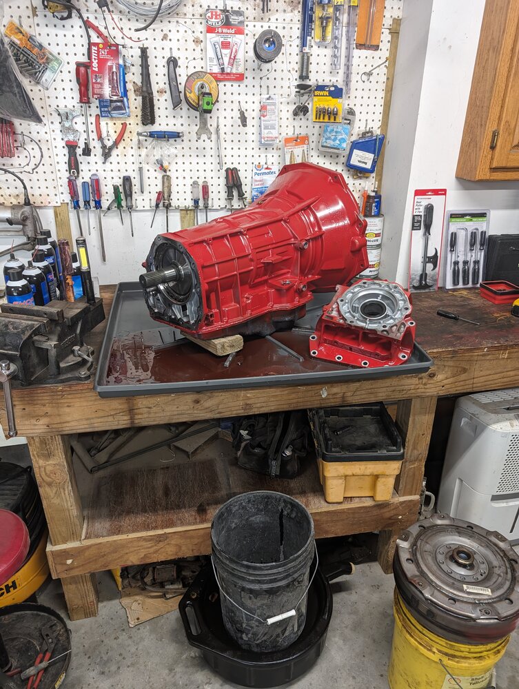

Pressure washed it, taped off the t-case and hosed it off with red engine enamel and started the rebuild on top of the wash machine / transmission drain pan.
This is a fairly involved mechanism (surprise). There's a gazillion pieces inside that supposedly have an order to them per the 100 page atsg manual. Fortunately, Randy's preassembled as much as possible.
Took it apart, cleaned it out, didn't see any damage, some light clutch material but still plenty of clutches left. I'm certain the valve body is the culprit, but still glad I'm doing the stage two kit so I can confidently turn up the motor.

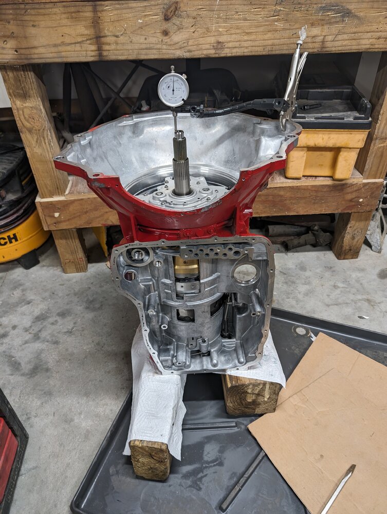

Get all the guts back inside and measure endplay on both input and output - Its too tight... So apart again and I have to order thinner shims. Tried to order shims with the kit, but Randy's said I would need to know which one to order, and likely wouldn't need any. But since I'm on a deadline I tried to order an entire shim kit from my dealer who had absolutely no idea what I was talking about... Should have tried harder... Uhg now I'm stuck waiting on two plastic shims...
Picked up shim kits from the dealer this afternoon. Pulled it apart again, reshimmed and got end play on both shafts within spec.

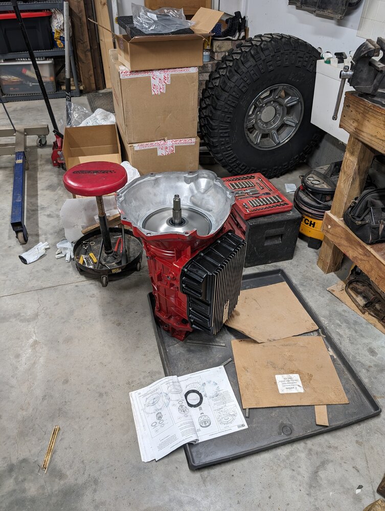

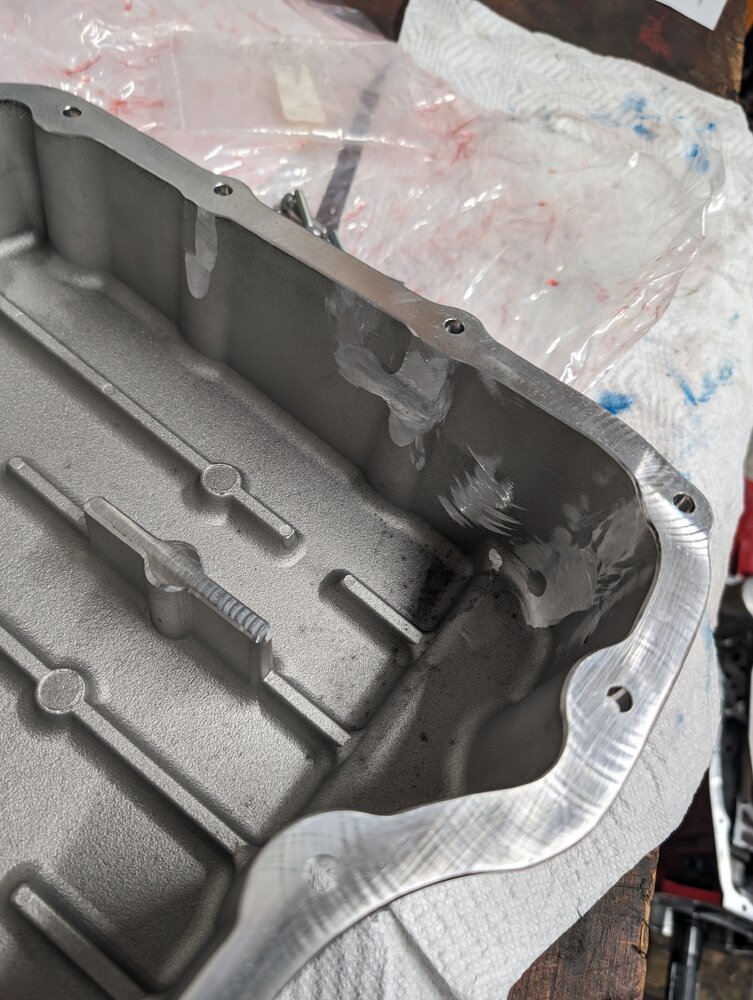

Back together again and on to final assembly. Had to "clearance" the inside of the new pan to clear the filters and valvebody. Took a good bit out of the corner where the spin on filter was interfering...
Air , brake clean, more air and put it on with the pump cover
All together before going under the truck

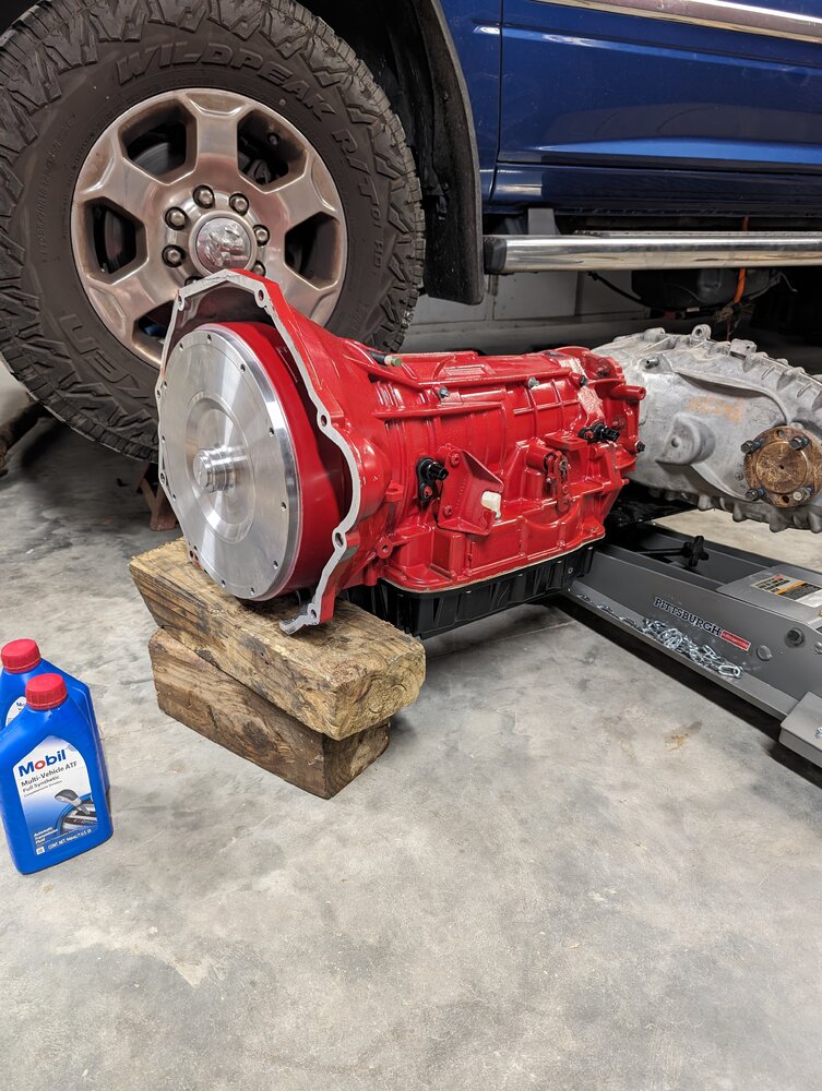

Had the truck higher, but it still wouldn't fit under while on the jack. Fanangled it under there with floor jacks and then cribbed it to get the transmission jack back under it. Rachet strapped it to the jack and up it went. Maxed out the jack and it was an inch to low so has to lower the truck. Got it to line up with minimal issues. Wired it up, and got all 6 torque converter bolts started, cross member in, and all bellhousing bolts in.

Here's the acres of room they give you to torque the converter bolts... I can just imagine that design conversation when that compromise was made, I guess it's not exactly regular maintenance but man that was tough. Got one click per swing on my 3/8 drive torque wrench - perfect:
