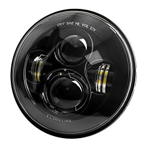

As many know last September I lost my step son to an ATV accident. Life is full of adjustments. I am starting to build a new house and need help from the brain trust here! Above my shop door I want to do a Jeep grill(he was 15 and we had been fixing him up a tj) and bumper. I have a new shell that came into one of my shops with a small dent and I bought it cheap. What I want to do is install the same led lights we used in his headlights and use them as a flood light over the drive way, then mount a bumper with down facing light to use over the door. I will use a dual switch inside the shop to turn them on. The down facing light will be easy as I can just use 110 light and hide behind the bumper. Do any of the electrical gurus know of a transformer that I can use to go from 110ac to 12v dc and handle the current the head lights require?
Here are the specs on the lights.

Voltage12 Volts
Wattage45 watts

Each light is 3.75a this should be fine. They make higher rated ones depending on the other lights you use.

Those headlights are roughly 4 amps each (45W on the specs shown above), so that's easy. I just did a quick Google search and found this:
Something like that should work great, and there's plenty of output power. Honestly any type of automotive-voltage power supply will work (anything within the range of 12-15V is fair game), as long as it's at least 100-ish watts of output plus some additional headroom. There are lots of options out there that look like a laptop power supply, but only have a single-voltage DC output, and you can just chop the DC plug off and splice it into whatever. Those are generically called "AC/DC desktop adapters".
For example, something like this:
Just get something quality. Cheap crappy stuff is fine, until it has a short lifespan or it doesn't meet the advertised specs for output current, etc. If it puts out like 150W but costs $25 on Amazon, be prepared for disappointment, or to buy it more than once.
