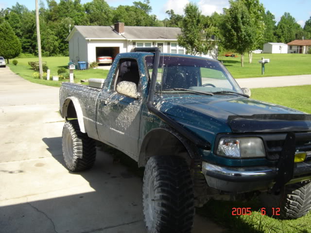

well i taped up some wires to help waterproof the truck a little better and i headed off with a friend. we were alone so didn't want to go to big. we drove around and finally found a trail with some mud. went through the first one in 4high and it was a breeze. next was a killer hole. jumped out and put the truck in 4 low. and checked the hole for its depth. the hole seemed like it was gonna be doable. i jump back in the truck and hit the hole. its deeper than though and got about 3/4 through it and the truck stalls. shit i got water in the intake. tryed to start the truck and it started and pulled itself out thanks to the 35's by mickey thompson baja claws. after i cleared the hole it died again. i new exactly what happened. pulled the filter and it was drippin wet. so i try and try to get the truck to run with no filter and it finally gets to where it partially runs without it. i turn the truck around and hit the hole again. i tried to stay farther off to the side and worked okay for a sec but the truck dove straight to the center again and drove right through it and died soon after. well the hard part was over. just limp it back to the house. the house is only about 18 miles away. the truck got home okay and i decided it was time for a snorkel. off to lowes i went. bout some abs plastic tubing and started fabing up the snorkel. i'm almost finished. just need some mounting brackets for the outside of the truck.
Nice job on the snorkel fab.
I think you were damn lucky you did'nt hydrolock your motor though.
Cool with the home engineering. :beer: Now to test it out. I want a picture of you with the snorkel doing its job. :D

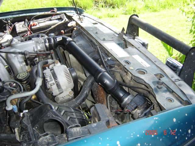

Hey where did you go wheelin at down there?I used to be stationed down there back in '99! Catfish Lake road?,or down by the minnesot ferry?Man let me know how the snorkel turns out!What is that motor in the picture near the fender?Homemade turbo?How does it work?-Robbie
the only thing near the fender is the maf sensor and the stock airbox just chillen in there. i had not taken it out when the pic was taken. other than that stuff nothing is there.

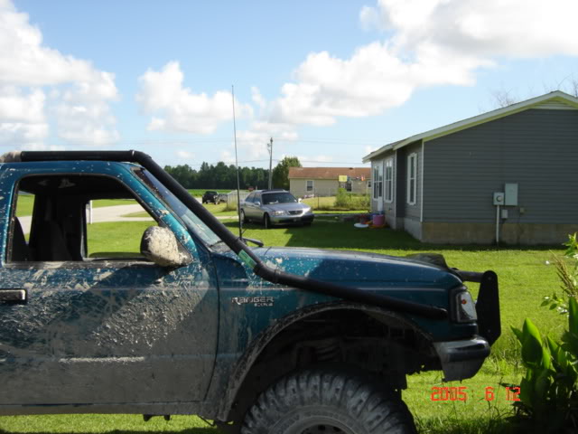

Just a question. Where's your air filter on the snorkel kit?
its hangin off the back of the cab. i'm gonna redo the snorkel soon. i'm gonna find an airbox that i like that fits my purpose better and go safari style with it.

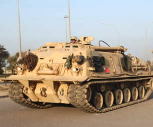

Maybe one of THESE...
M88 Recovery Vehicle
Tank Recovery vehicles like the M88 were designed to recover damaged vehicles from the frontline while under fire. The standard ARV in the US Army immediately after the Second World War was the M74, designed by Bowen-McLaughlin-York (later BMY and now part of United Defense), which produced over 1,000 vehicles.
The M88 initially began life as a replacement for the obsolete M74 medium duty recovery vehicle to allow the recovery of front line US M48 tanks. BMY was awarded a contract to build three prototype vehicles under the designation of T88, to use as many components as possible of the M60 tank. These prototypes were followed by 10 preproduction vehicles for troop trials. Production was approved in 1959 when Bowen-McLaughlin-York Inc. signed a contract with the US Army for 1,075 vehicles, with the first production M88s completed in February 1961. The design turned out to be an extremely durable and well-planned Armored Recovery Vehicle (ARV) and the type was added to the military inventories of many countries from the 1960s on.
Though this vehicle has very good recovery capability & features, it fall short for crew protection. The hull of the M88 is of cast armour and rolled armour welded together, with the crew compartment at the front and the engine and transmission at the rear. The driver and mechanic are seated at the front of the hull, each with a single-piece hatch cover and periscopes. It had a front spade used primarily to stabilize the vehicle during lifting and recovery operations. The main winch could be used to drag a disabled tank or one stuck in mud back to an area where it could be towed or driven away. The boom could be used to lift tank engine-transmission units from tanks for repair. The towing pintle and tow bar could drag a disabled tank to a secure area for repair. The M88 was also used at the transport vehicle for the mechanics. It carried welding equipment, tools and spare parts.
