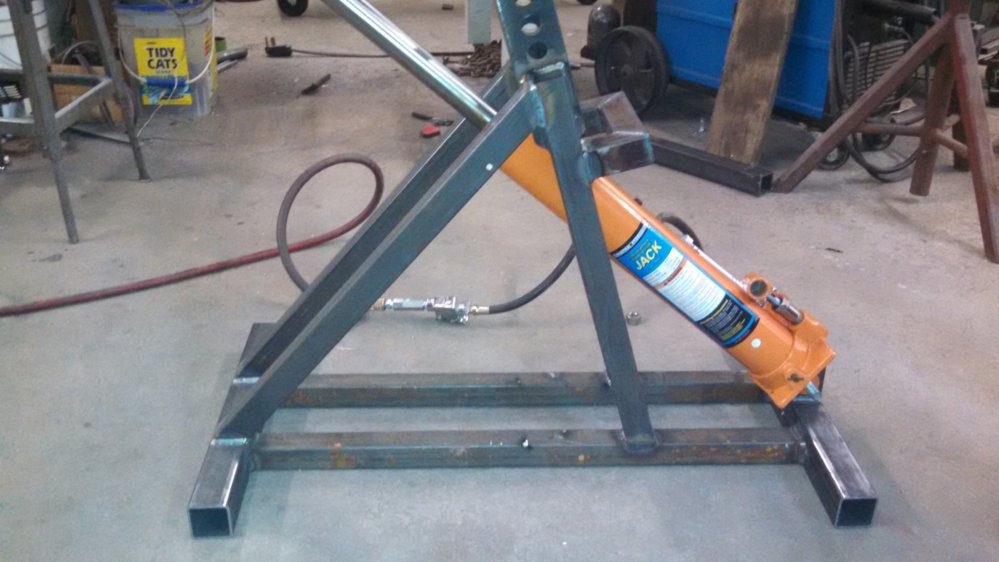

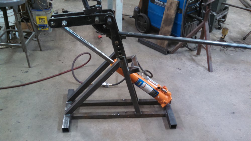

On the first I built my own mount using round tube cut in half, welded nuts top and bottom to squeeze the air over hydraulic ram, it worked great

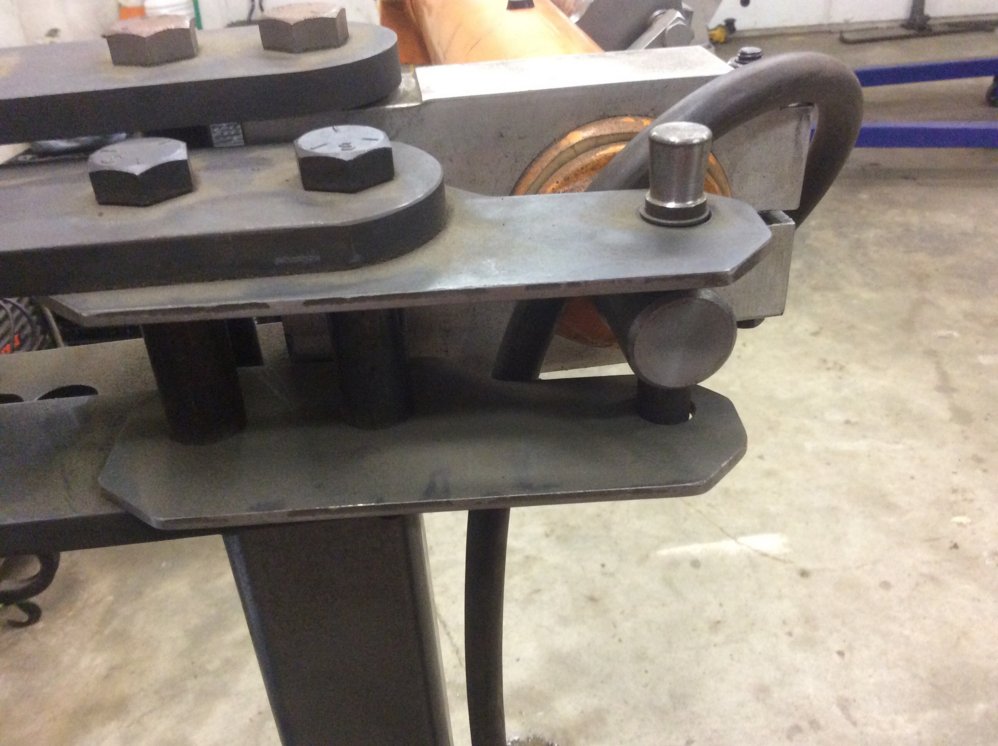

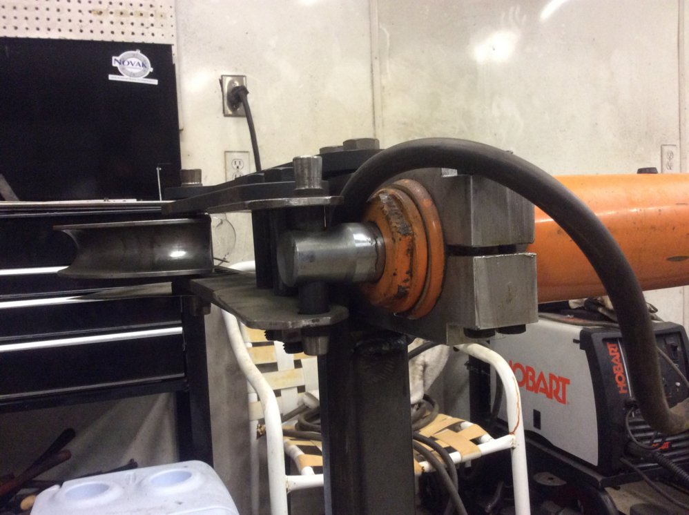

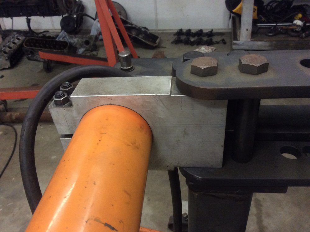

I have one of Guffey's Tube Tek benders here at the shop! The mount that came with this one mounts the air over hydraulic cylinder from Harbor Freight. Pretty simple aluminum mount.

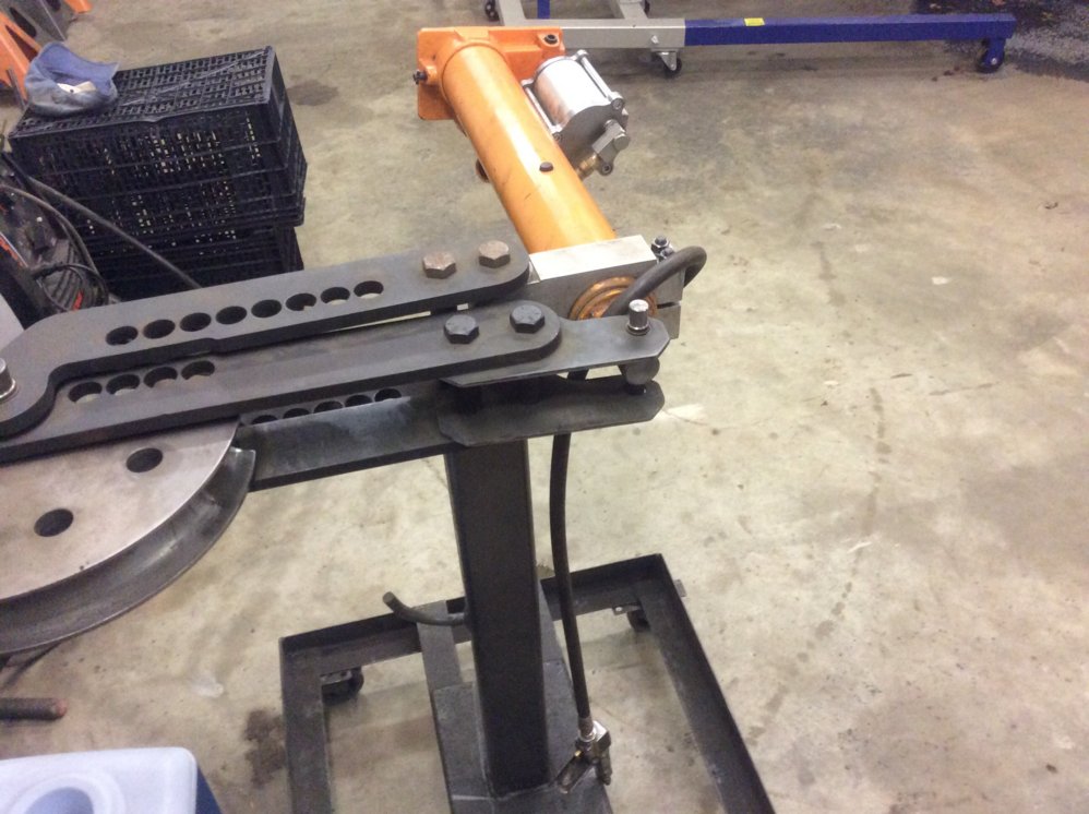

Back on topic, I've got an ancient Hughes Engineering Model 3, predecessor to the JD2. The mount/clamp system it used was functional, but ridiculously complicated. I built a mobile base for it, converted it to bend in the vertical plane rather than horizontal, and incorporated the HF Air over cylinder. Took an afternoon. If I had spent a little more time on it, I could have made it even better, but I didn't. ;) The cylinder is just pinned into the frame, so when I need to slap it into my engine hoist, it just takes a minute. It works beautifully, and rolls out of the way when not in use. I'll try to upload a couple pics to give you an idea.
