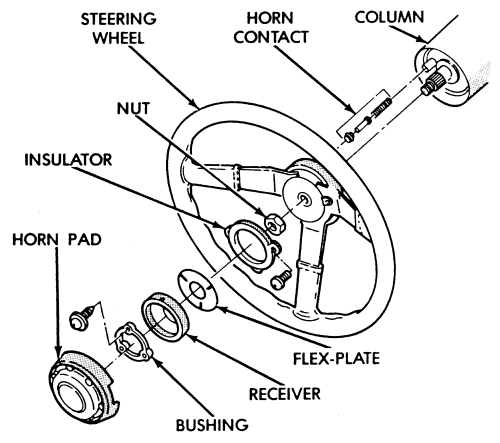

I'll try to explain this the best I can without having pictures of my actual rig handy.
1) Removal of the steering wheel is straight forward. You'll need a steering wheel puller but those can be had for ~$15 at any parts store. You can set everything to the side except for the factory nut that is used to hold the steering wheel to the column. You'll need that to help ensure centering of the disconnect coupler.
2) there is a thin plastic cover that remains over the end of the steering column once the steering wheel is removed (it's not shown in the attached diagram for some reason). You'll need to remove it (but keep it for reinstallation) and the horn contact plunger. There is also a small plastic guide for the horn plunger. That will need to be cut as flush as possible with the end of the column housing.
3) The Joes racing splined coupler will slip over the splined section of the column and should contact the smooth portion of the column behind the splines. Take the factory nut and put it on backwards. One side of the nut is rounded/tapered. Threading this on so the tapered end is going into/against the splined coupler will ensure that the coupler is straight with the steering column.
4) I tacked the base of the coupler (closest to the steering column housing) first. Then removed the nut and welded the end of the coupler to the threaded portion of the steering column. After that I finished welding the base.
5) Once welded on and cooled down, I reinstalled the plastic cover (removed in step 2) and then the steering wheel.
I hope this helps. If it's confusing, I'll try to remember to take pictures one evening after work and post them up.
