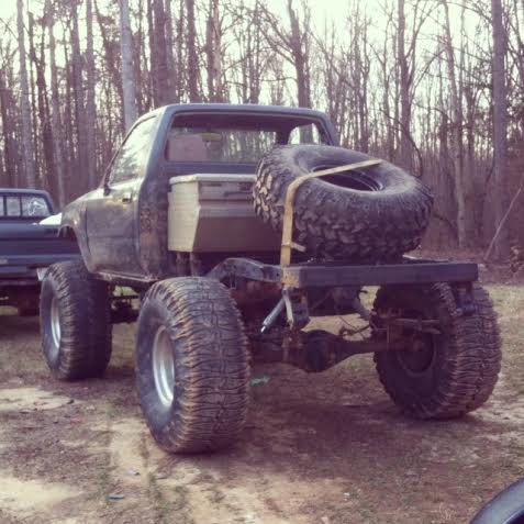

Picture right after the bob job.

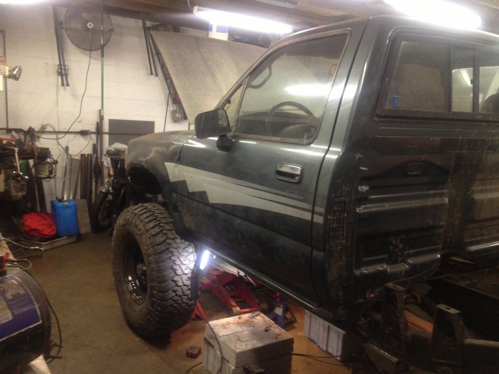

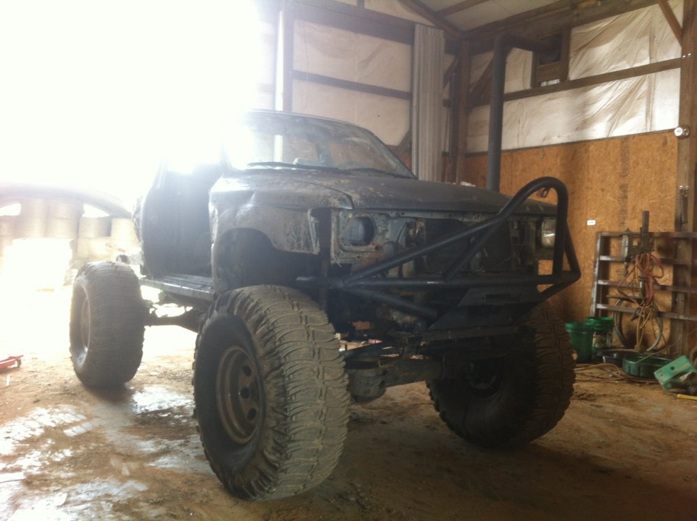

after sitting on blocks for a few months im back at it, put a set of 39.5 15 16 on it next on the list is spacers for the rear (tires rubbing the frame), cut fenders, 5.29s, lockright in front, and a steering stabilizer. it wanders all over the place and Im not sure why
I see broken birfields in your future, a call to longfield is in order.
Sent from my mobile Toyota base using Tapatalk

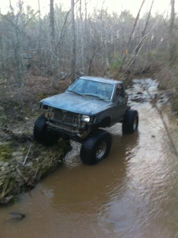

I have been beating the shit out of this thing and cant seem to break anything. I junked the bed and bolted on the toolbox and spare tire. robbed the front bumper for another project but hopefully getting a stinger for it this weekend. it really needs a locker in the front but I was kinda waiting for the stock axles to snap to tear it apart and put a lock rite, chromoly axles, and 5.29s. maybe im not hard enough on ityota 2.jpg yota1.jpg

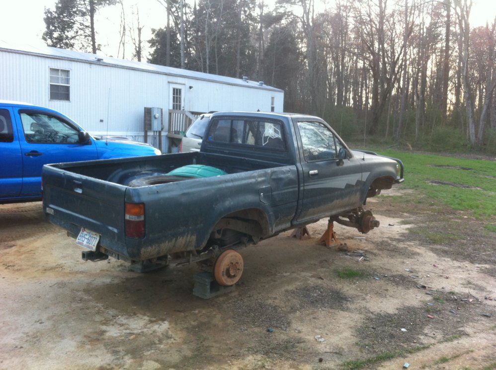

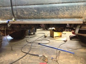

Well the fun has kicked off on the"new" rig. Starting with the back 63's a nice shock bar and some other odds and ends..
It's hard to get good progress pic with such a crowded shop.

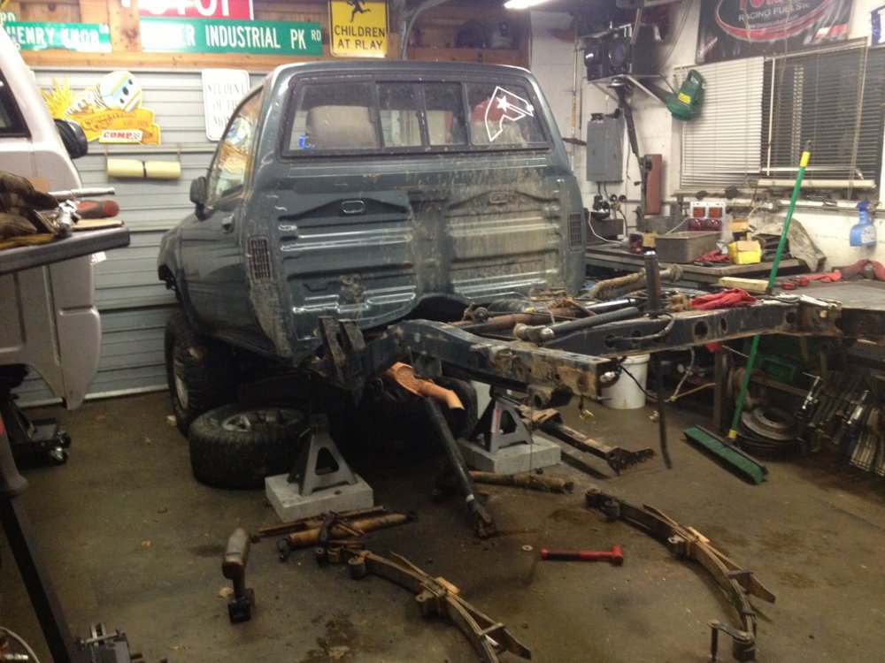

Update ....
63's are on mounts all welded, waiting to fully weld the spring perches until its setting on all fours. Still have to do the shock mounts upper and lower. Going to tie the rails together at the end probably do a receiver hitch tube in that as well. Trying to talk him into a flatbed but we will see..
The front ifs junk is all gone rails are cleaned slick. Frame tubes are in place an all welded. Spring packs are built but 100% not finished. Still need to bevel the ends extend the spring clamps clean and paint. Used the factory rears from this truck and three more leafs from another, ditched the overload leaf. Working on tuning in the front hanger to get a good shackle angle, Iam 2" forward from where trailgear says to put it and that's at the end in the road for the rails. Some of the body mount will need trimming to keep the shackle slamming it, bump stops will be a absolute must. The springs set near flat with weight on them and everyone claims the go negative pretty easy. And the steering box will have to go way forward.
