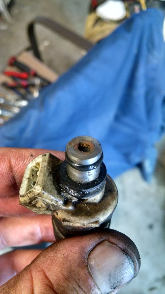

I'm working on a 22RE and want to have the injectors cleaned and checked for spray pattern. Anyone have any experience?

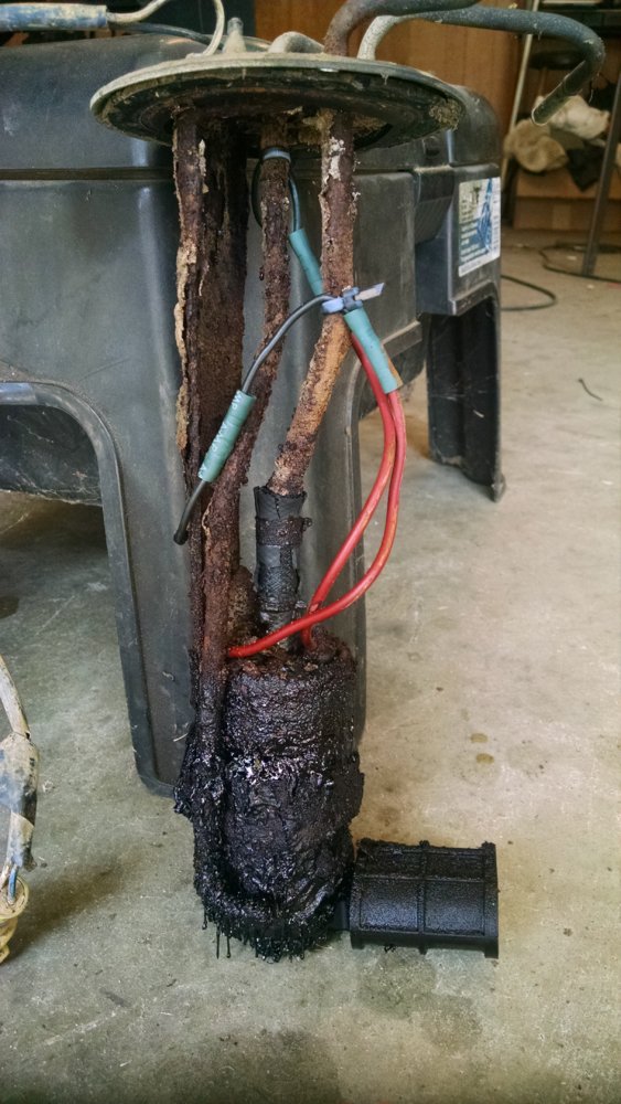

The injectors definitely have trash in them and the fuel pump speaks for itself.
Race City Injector in Mooresville, else RC Engineering can clean and flow test those for you. RC has been doing that for decades, but they're not local if that's what you're looking for. I've used RC a few times in the past.
Awesome! I'll be in Mooresville today. Thanks
I did the LCE thing twice. Once a decade ago when I rebuilt the engine, again last year when I had a leaky injector and it needed rebuilding anyway. For the money it's worth it. I think my total cost w/ shipping was like $30, didn't have a local place.
