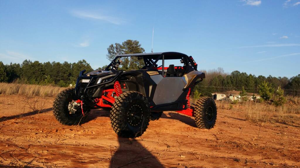

I've spent a lot of time in full size rigs, whether it was crawling or going fast. The SxS are more fun but they aren't going to take the beating that the full size stuff is going to take, especially in the rocks. BUT they are way more nimble, you can ride at at least triple the amount of places that you could in a full size rig and you can go faster than a dirt bike or quad on the trails and still be technical and play in the rocks. I've built a handful of the X3s so far, lots of the older Mavericks and the X3 is the most fun I've had out of any machine.

Yeah I actually built that SxS. He wrapped the gold with a highlighter color. He broke a spindle side radius rod bolt amd it killed the spindle when it broke.
It's getting closer and closer with every new model but it's going to take time. Weight is the enemy and getting the setup to hold a beating and without adding a ton of weight is extremely hard.

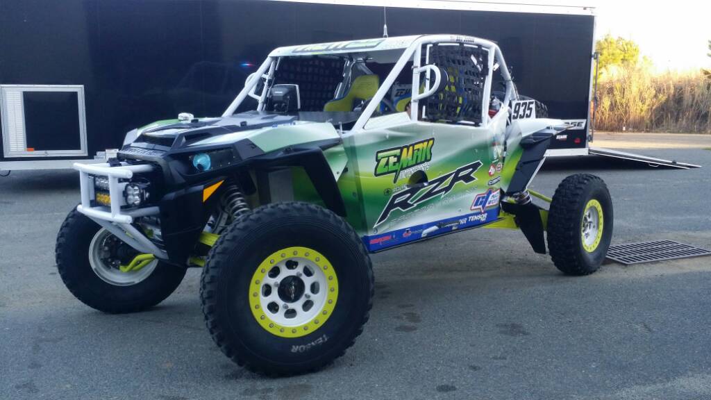

We both run the same platform. A 2017 RZR XP Turbo 4 seater turned into a 2 seater. They look like mini 10 cars. We all have our little unique tricks that we use to try to make parts live longer.
