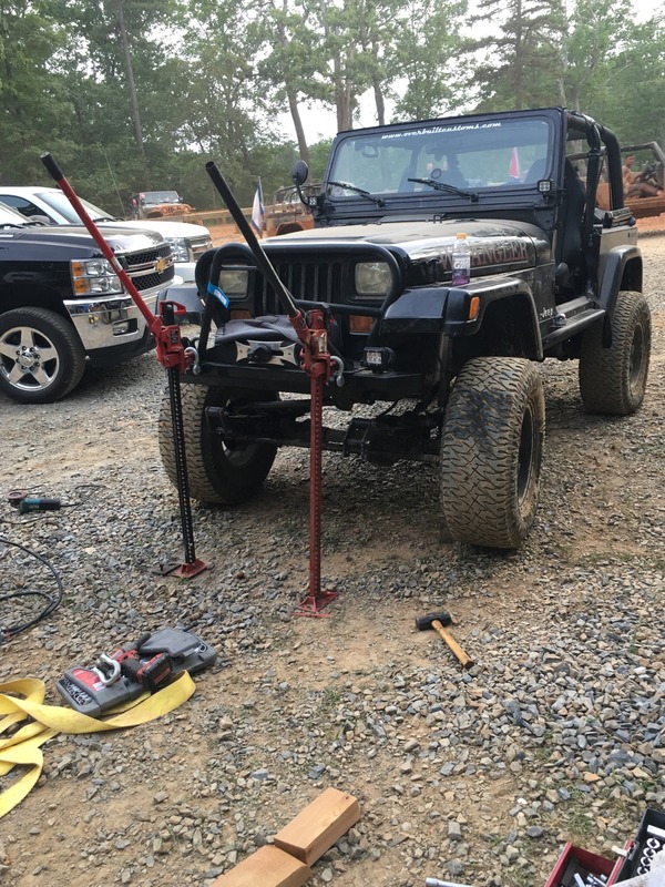

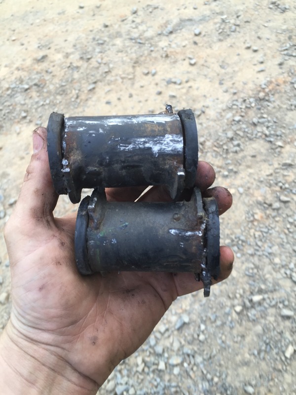

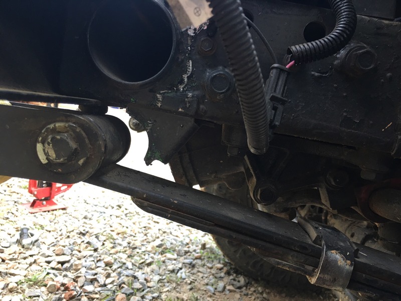

Made it through almost the entire park. We were hitting the last trail heard a little bit of popping, but I thought it was the lunchbox up front, then all of the sudden I couldn't turn left. Pulled off and both front shackle mounts has ripped off.See carnage.

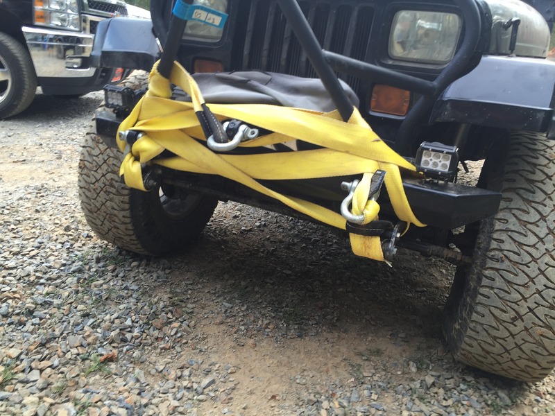

Trail fix to get me to a camp with a welder

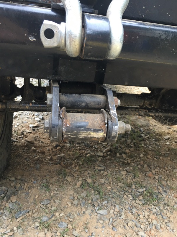

At camp
ai54.photobucket.com_albums_g110_holmes9898_Uwharrie_20Memoria93ca210db96711ba1c263f3eb0a32bcd.jpg
ai54.photobucket.com_albums_g110_holmes9898_Uwharrie_20Memoria783dd3fe51afecd0ce7ce611a7bb9036.jpg

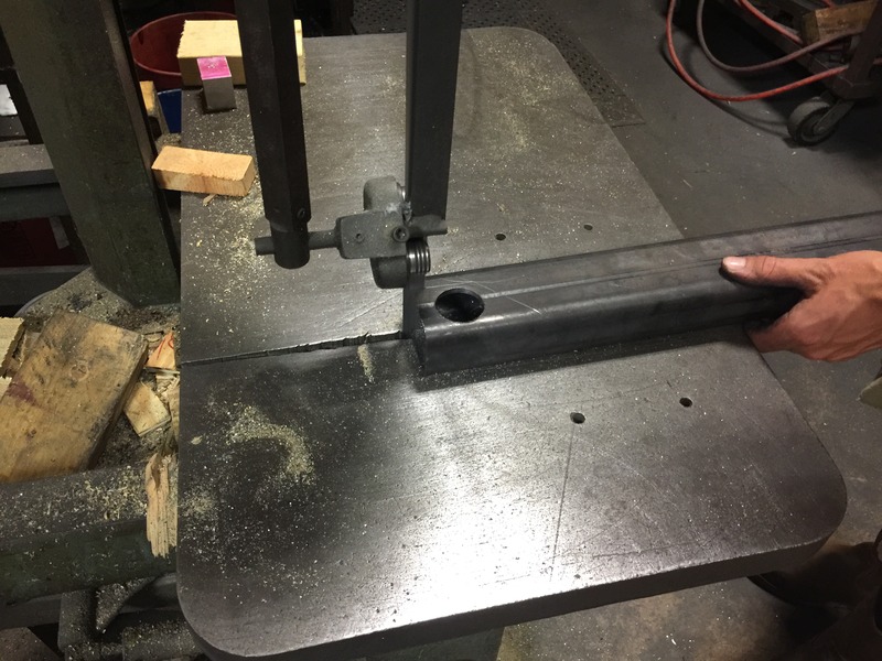

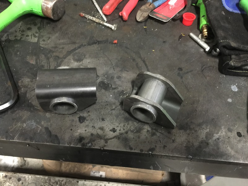

The generator running the welder wasn't strong enough so needless to say it was some bird poo looking welds to get me to the gas station outside the park where I met a flatbed. Towed it to my brother in laws industrial shop. Next day it was time for upgrade. We fabbed some new much stronger hangers and got them burned in.

very nice trail fix and upgrade!
Seems you had an unusual bad break, but a good day of wheeling! And a Good break, that the Shop was close, & you got a Beautiful Upgrade!
