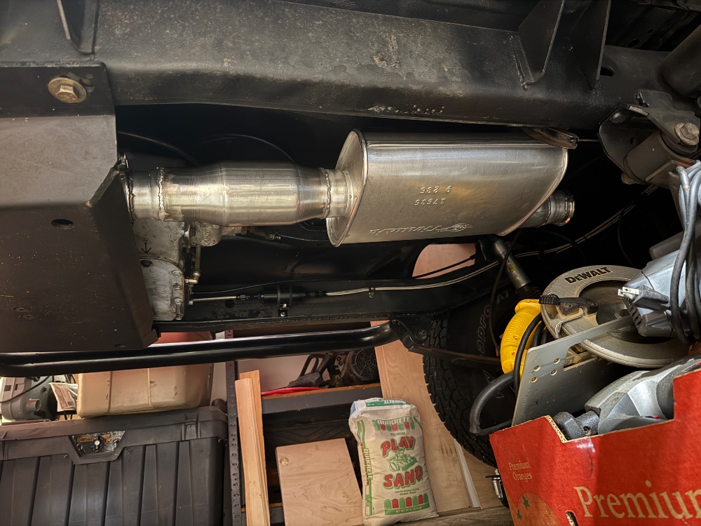

Back on the exhaust on my Jeep and I keep going back and forth. Should I put a V band (or other style clamp) before the muffler on my exhaust? What about before and after the muffler?
I'm using the cheapest 2.5" pipe I could find on amazon so it rusting out and needing to be replaced is basically a guarantee.

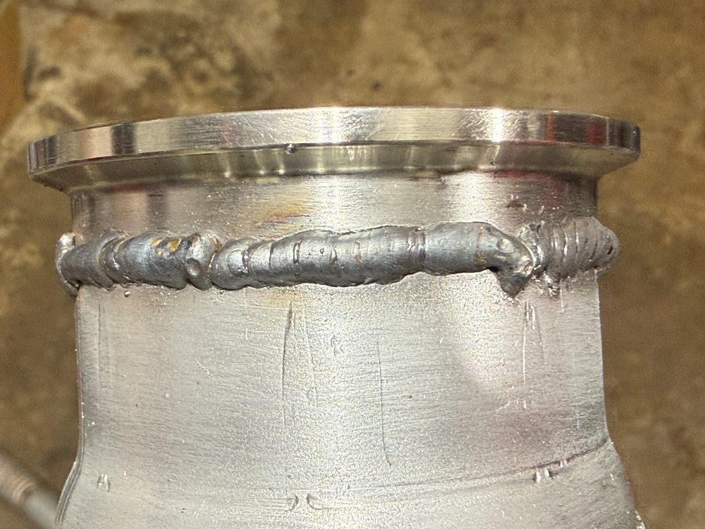

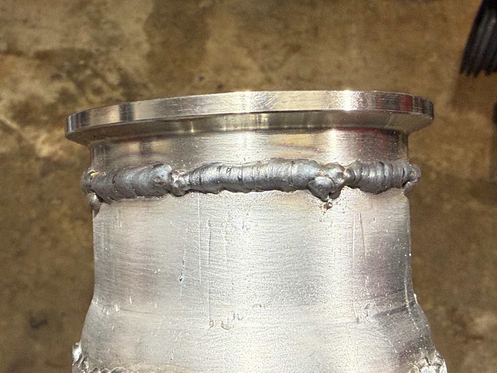

I replaced the flange on my 99$ amazon manifold with a 2.5" v band clamp, pie cut for the engine and turn back, then another v band before and after the cat. then out the back. all 2.5 aluminized. tig welded the stainless and mig welded the rest. wire brush and wood stove paint. 4.7 stroker in 99 xj
Have 3 V-bands on the exhaust on my buggy. Fits great, zero leaks, easy to remove and reinstall. Cut the flat 3-bolt flange off the exhaust manifold and replaced with a V-band. Long section of exhaust runs under the floor then second V-band before the bullet muffler. Third V-band is before the muffler at the rear of the buggy.
