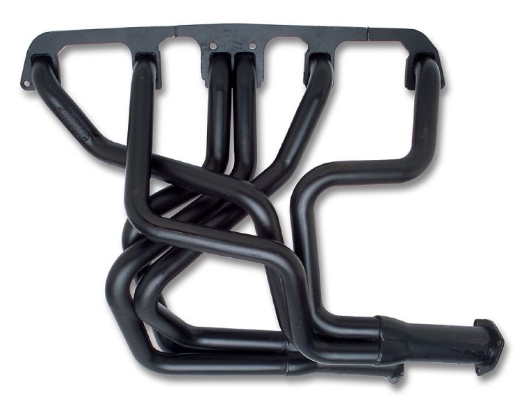

^^^^ and a 258 with a dual-outlet header sounds badass.
If you like headers. I don't.
