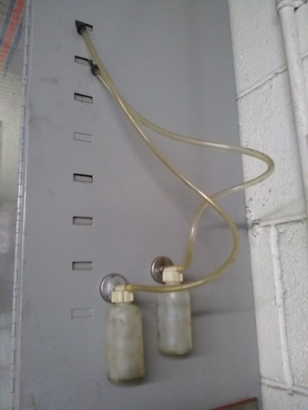

This on a bucket or something that is higher than your bleeders....... And you'll be hydrated.

This on a bucket or something that is higher than your bleeders....... And you'll be hydrated.View attachment 281071
I’ve been using the bottle and tubing method for years, but thought that the newer technology might be better. But maybe not...

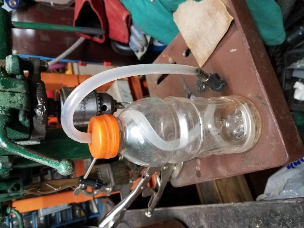

I was gonna post a pic of the waterbottle and tubing method, but someone beat me to it.
Since I work by myself ALL THE FREAKIN' TIME that's the way I do it.
The added benefit of flushing old out and almost always putting in all fresh fluid is major win.

I just use longer tubing and put the bottle where I can see the tubing going in ..... pump until there is no mo bubbles.
