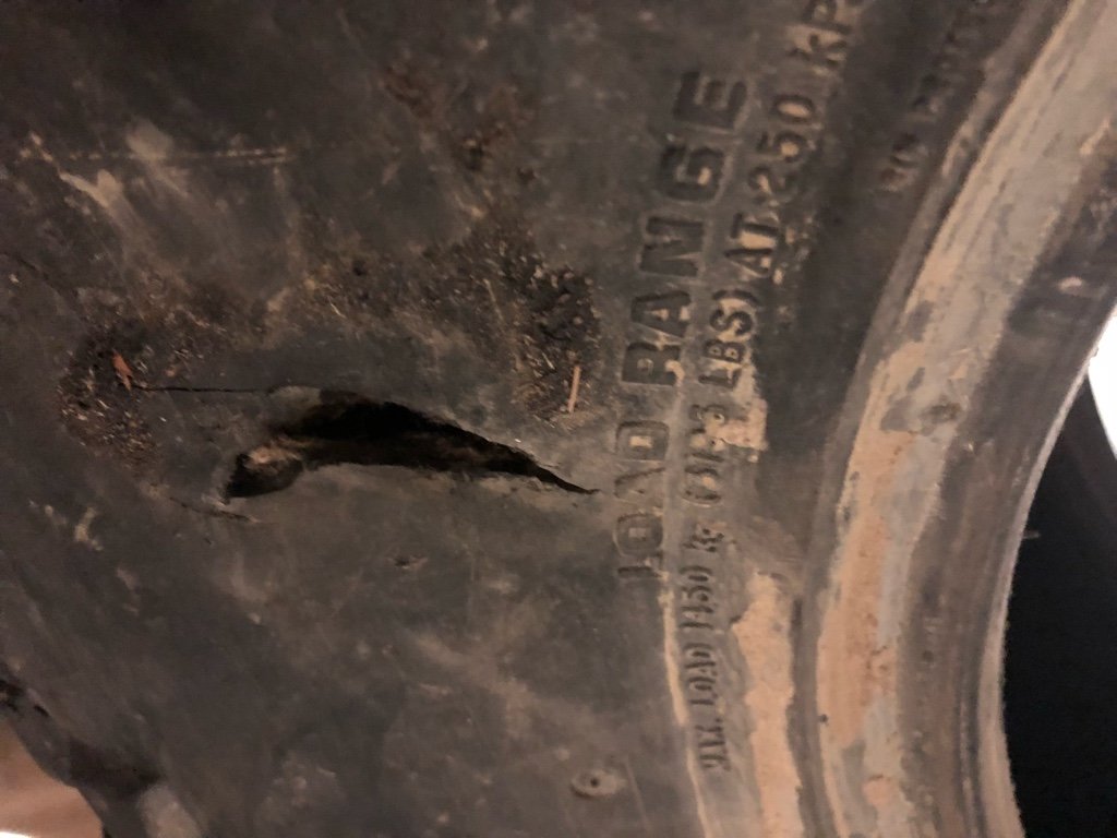

The cut is a couple about 2" and the leak is very slow.
I'll get some pics this weekend when I have time to get it off the wheel.
You will have to make it a pretty big to fix it unfortunately you have to grind out all the cut part and kinda feather it out like you would to weld a crack in metal

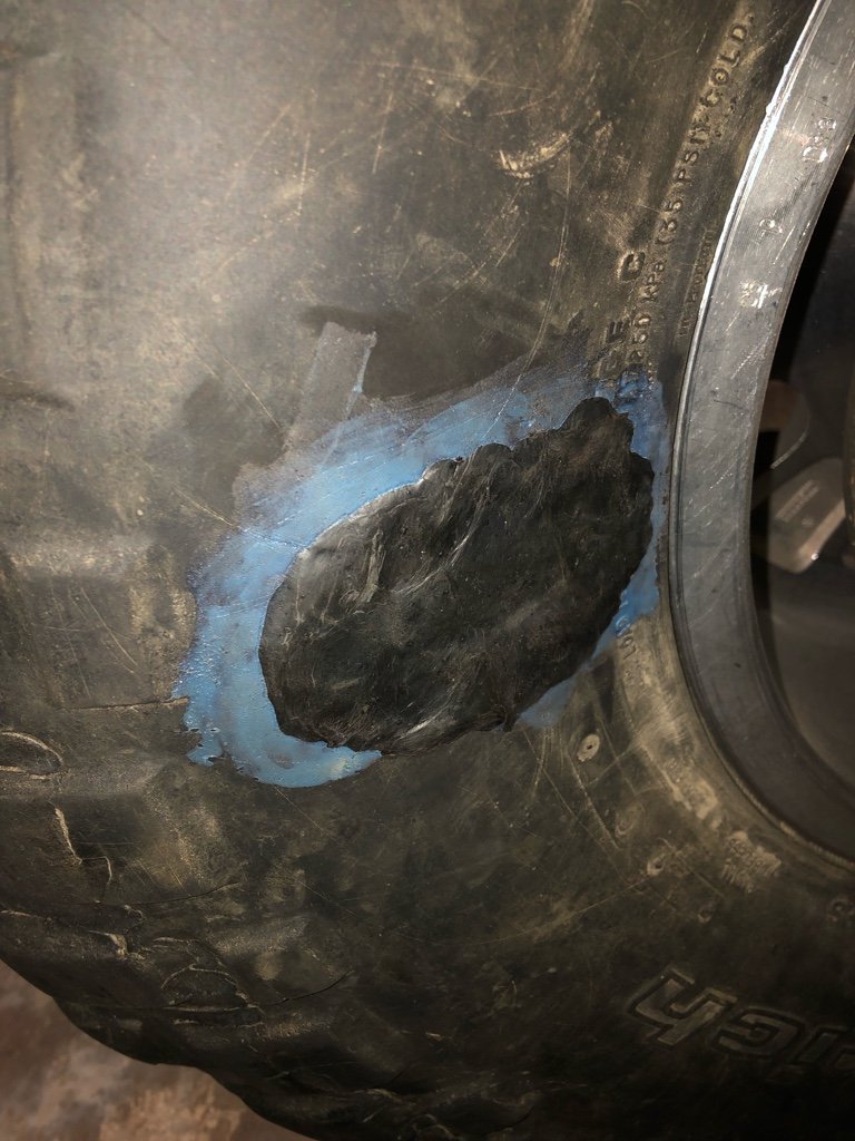

this is the last one I did just to give you an idea

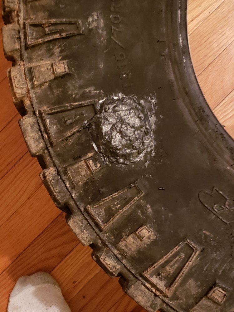

Well here it is. Not as pretty as the one in previous pics. We will see how it holds. Hole was size of my little finger.
That stuff is crazy sticky at first lol at one point I thought I would never get it off my fingers
I was wondering that too. Difficult to work with while it's in that state! Got much better as I worked it though.
this stuff is still pretty soft. I read 24 hours to dry. I have kept in 68*. Does it stay kind of soft? should it get hard?
It will harden up. The more time goes by the more it cures
I built a fire and rolled the patch in front of the hot air blower. helped quite a bit. Thanks
