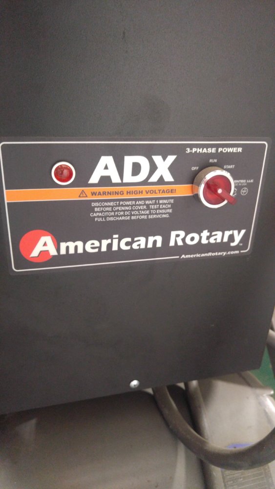

I have an American Rotary rotary phase converter. It works. Reliable, quiet, efficient, but not cheap. If VFD will meet your needs, do it. But a rotary phase converter will make it easier to collect large, cheap machines that you don't need :D
