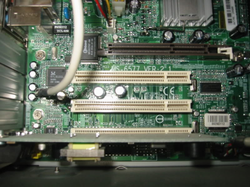

Here's pic of open slots. The dark one I assume is the AGP slot?
What are the 2 white ones called?
Thanks for help
Right, the brown one is an AGP slot. The three white ones are PCI (not to be confused with PCI-Express, which is a graphics slot.)
With 512mb of ram... I'm on the fence. My gut is that it'll do low-res fullscreen video without studdering. I have a P4 of similar age (using it at the moment), with a Quadro 500 (same thing as like... a GeForce 5200) but it has a gig and a half of faster ram.
Something else that might inform your decision... look at the capacitors around the processor. They're the small cylinders. If any of them are bulged on top or visibly leaking, I wouldn't spend any money on a video card.
