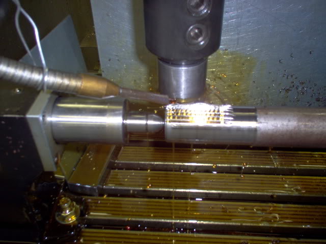

That is basically the same principle as a horizontal milling machine. Had he been using a carrier or something to index it, and the cutting tool profile was correct, it would actually work fairly well. If you look closely, there are two bolts on the shaft, and a threading tool for a lathe. One bolt sets the depth of the tool, and the other holds the tool in.

an old machinist that can cut splines, gears and broach a little as well.

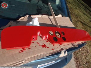

semi-thread hijack. I got bored and made this just to prove that chicken$hit can sometimes = chicken salad if you try hard enough. my old willys dash was just rotten to crap so I stole the column surround and made the rest out of 4 pieces of sheet that was laying around. 4 hours invested and $115 saved. recycling baby, recycling. and yes its oil based, brush painted, but who cares it a working truck.
