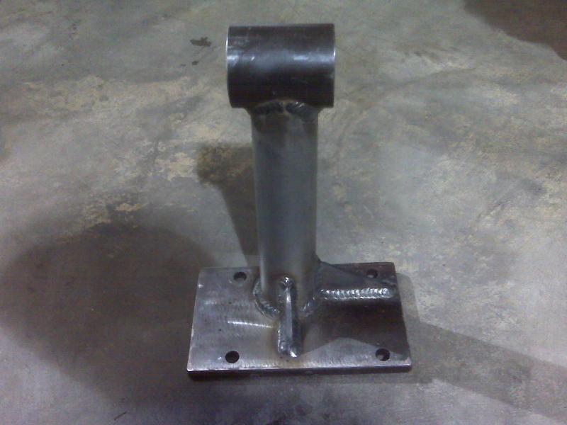

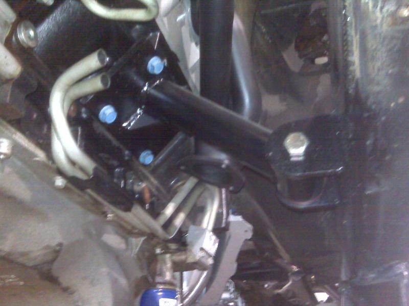

Here's how I did the motor mounts on a LQ4
