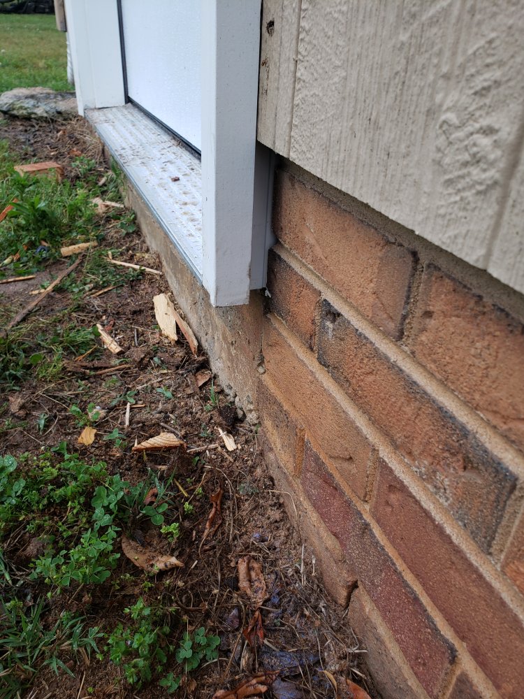

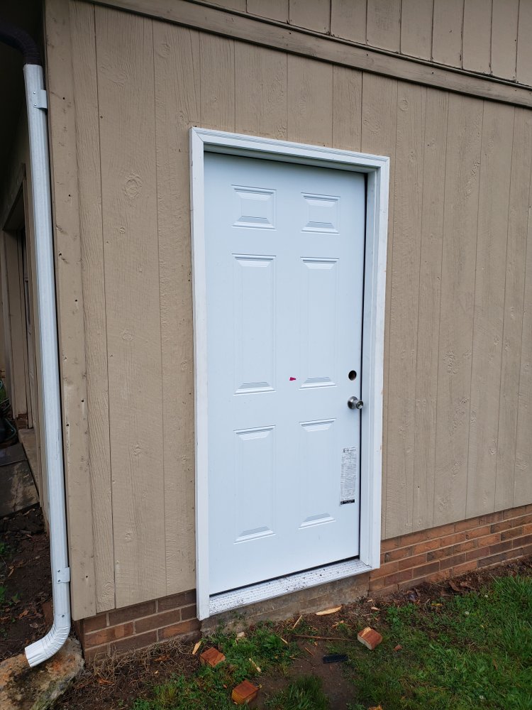

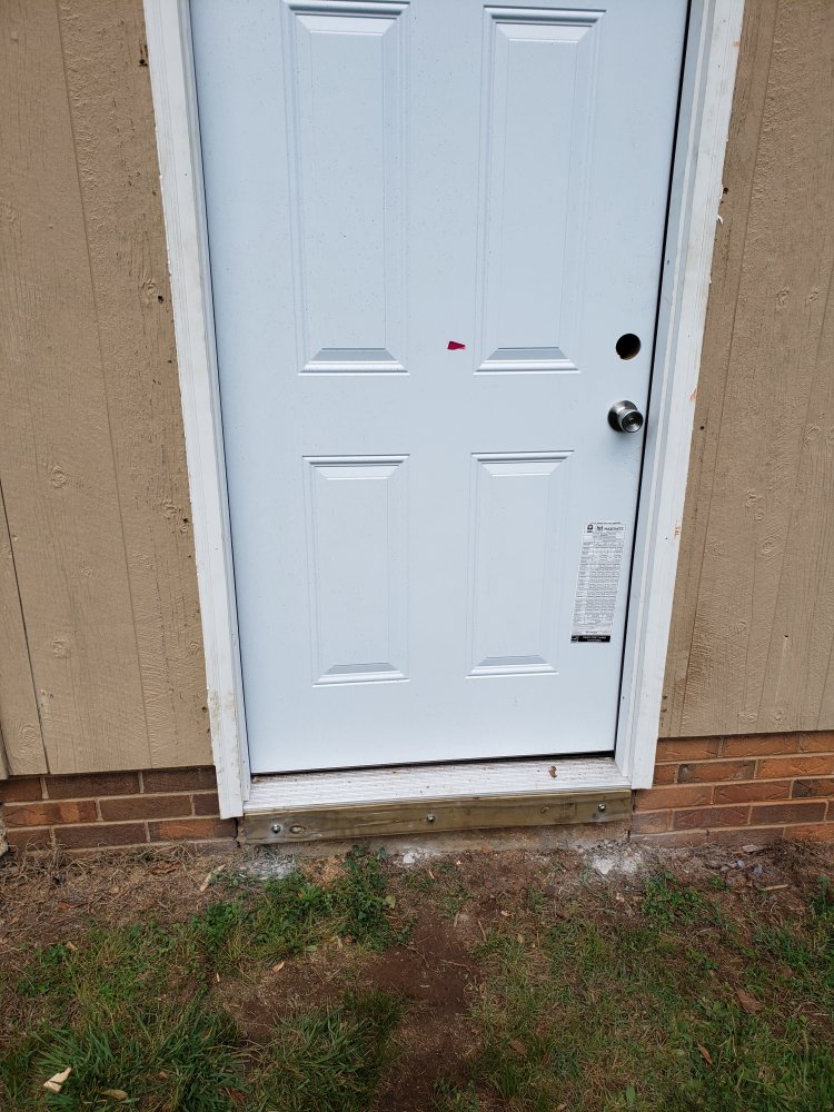

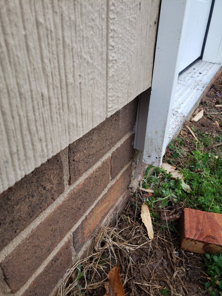

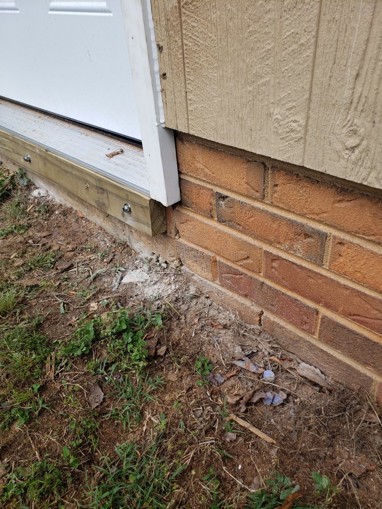

Installing walk through door on my work shop. Do I need to trim around the brick mold so the door sits against the framing or mount a pressure treated board under the threshold? I am thinking the trim but it the threshold will still not be even with the concrete. Also the concrete has quite the dip there. How does one shim the threshold so its solid?
Thanks in advance for any advice.

On the bearing surface for the threshold, have you thought about pouring a pad outside the door, maybe 3x3, sloped out. Give that threshold something to land on. On my old house, the garage man door threshold overhung kinda like that...the builder used about two tubes of caulk to bed it and fill the space. Of course, that eventually failed, but lasted a few years.
Shim the sides to match the siding. Add a pressure treated 2x4 at the bottom to support the threshold. Secure the 2x4 with concrete anchors.
You can do either method. The way you have it in the pictures is common if you have a porch/deck ledger below it, and there's a piece of vertical wood between the two (I want to say it's called a "kickboard", but I can't remember) that is just a support piece for the threshold.
Whatever you do, you need a proper sill pan under the threshold, and if you do use a kickboard or trim batten or ledger-type thing to support the edge, you need to flash it properly.
You also need head flashing (above the door), and to figure out how to waterproof the entire rest of the door opening and tie to the house wrap or whatever is protecting the siding. I'd trim back the siding at least, so you can caulk the brickmold to the sheathing after waterproofing the opening to the housewrap.

I believe I will trim the siding and use the 2x4 treated kick board. Thanks for all the replies.

If you go through the hassle of removing the brickmold, use flashing the tape from the jamb to the sheathing and then reinstall the brickmold. It’ll be a better barrier than any caulk job ever will be.
as for shimming the sill, you can use standard shims. The problem with that is you won’t have a good caulking surface between the sill and subfloor and a sill pan is the only good option (although most look like shit on the interior)
Came out much better.
