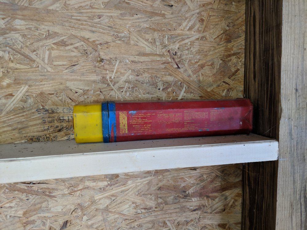

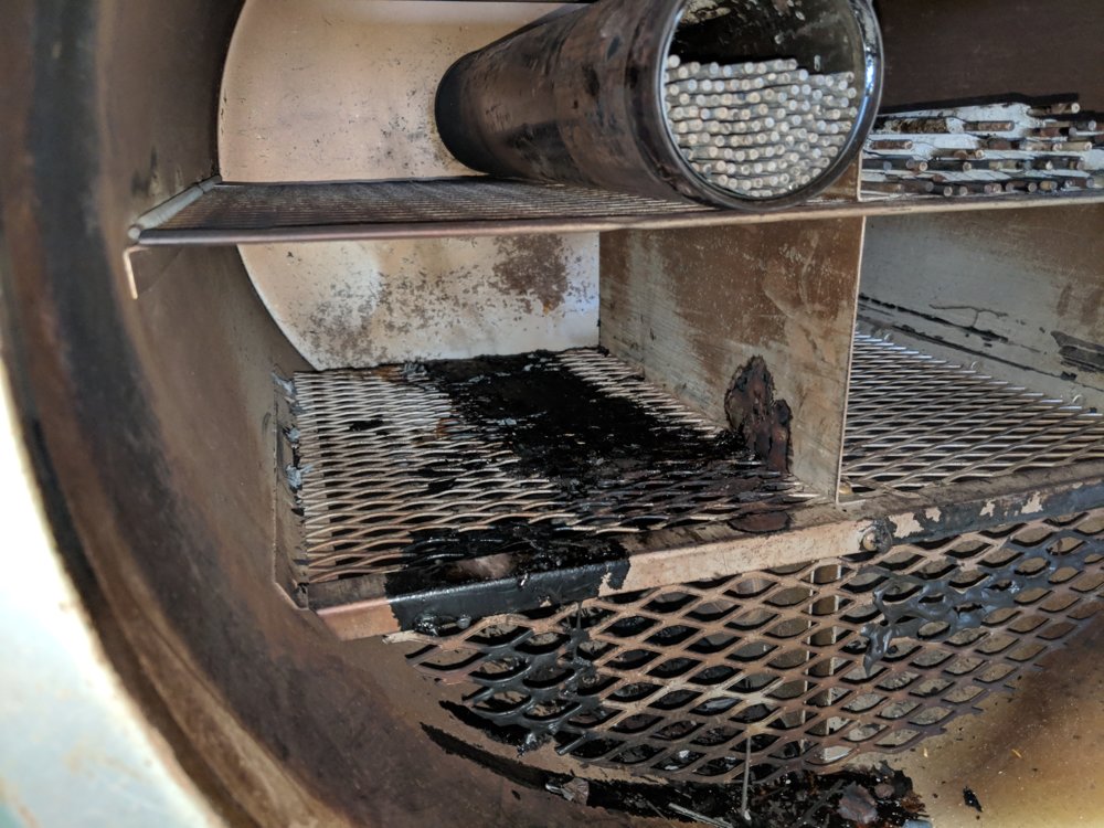

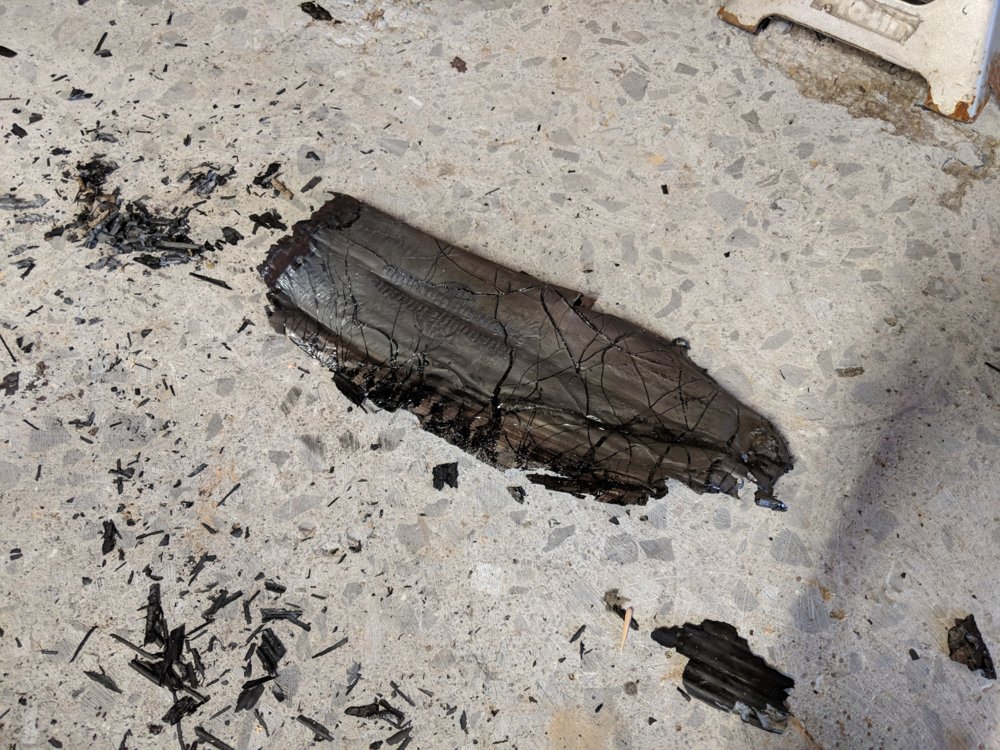

So you guys remember that I have a shop now that needed power? Yeah, so it's got power now. So my FIL gave me a rod heater for my stick welder. So after getting everything wired up and set where I want it I plugged the rod heater in but didn't turn it on....or so I thought. I walk in this morning and find smoke everywhere. I'm thinking, "great, you really just wired up your shop and now you've caused an electrical fire". After further investigation it was the rod heater. The thermostat control that's says "OFF" must mean "OFF...if I feel like it". I had a full pack of rods in there in one of those red plastic tubes. It gone. So here's the aftermath.
Yuk, man the ones at the college can be set really hot. I can see that happening. Good thing it was insulated and fairly isolated.
We never put plastic in them, only bare rod.
I just threw those in there till later. I wouldn't have turned it on with the tubes still in. I'm straightening out the shop now that I have power and getting organized. It was a temporary thing.
